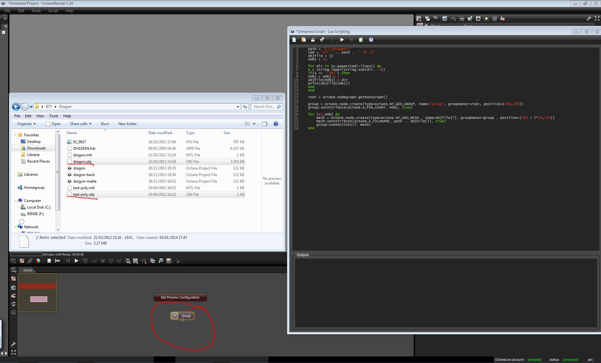

hi davve, thanks for sharing ;)
unfortunately it doesn't work, at least with 1.24, here is what i get:
ciao beppe

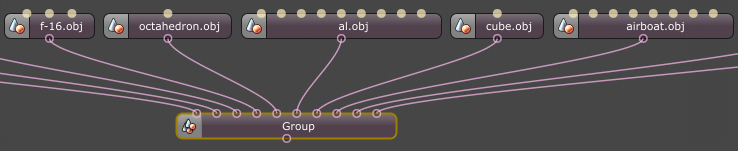

You should see something like this in the end:
group created from all the OBJ files in a folder
cheers,
Thomas
