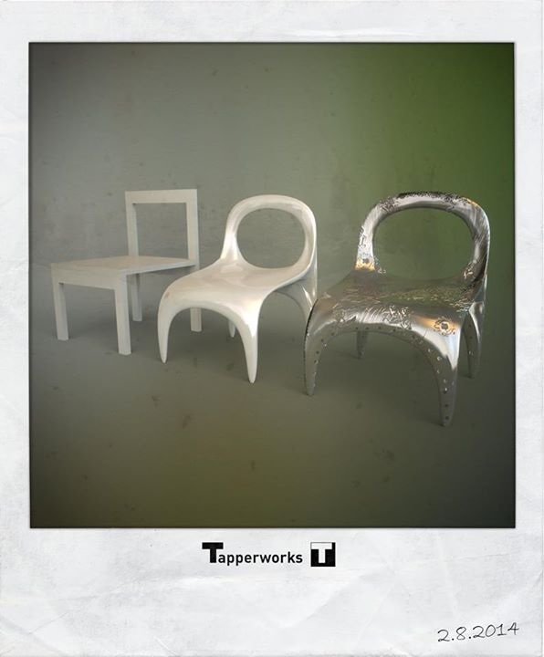

Left chair is modeled in Archicad, middle chair is modified in C4D,
and the right is object after playing around in Substance Painter.
All rendered with Octane Archicad plugin!
I remember the workflow was hard to get correct UV and normals usable in Substance Painter, but it was to be done as you can see.
Hard to explain the workflow, because I did not write it down while experimenting and I will have to do it again to recall.
But as said, it is to be done ;)
