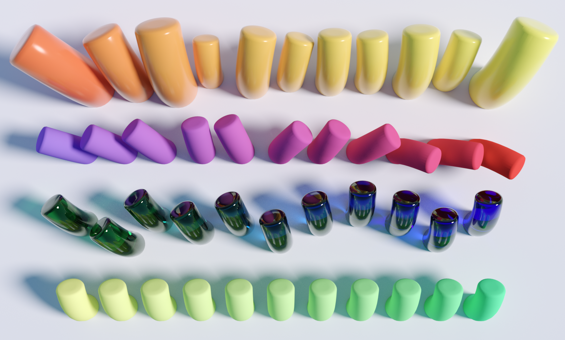

light lister script is here http://render.otoy.com/forum/viewtopic. ... 53#p149753
.. I incorporated it in my script as well, also the visibility script also by ooguz..
.. did a octane camera from viewport - it's not "ready to realease" but I am using it like this for a few weeks.. adapting random color and gradient from wirecolor scripts.. just so to make it compliant with octane.. also some basic buttons that otherwise need at least two button presses.. did most of it within a week..
try it out, see what you think
stuff you couldn't do without scripting (well not as easy)
.. works on max 2014 anyways (probably on older versions, but did not test yet)
..there's a script for max to do clay rendering (for standard materials).. I guess I just need more info on octane properties..
from script - gradient from wirecolor
script
octane_toolbox.zip
(5.77 KiB) Downloaded 317 times
