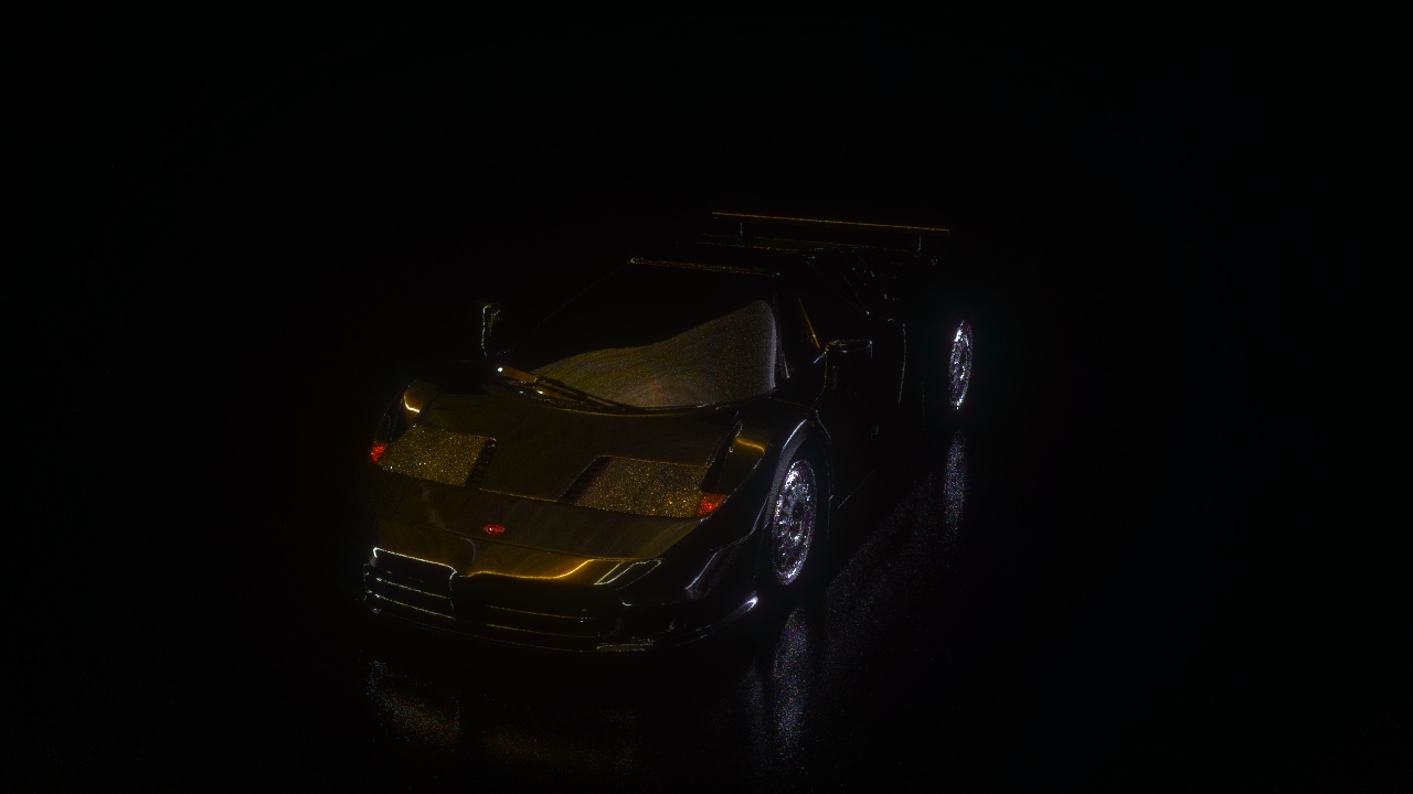

I'm trying to make an animation with directlighting and so far, everything was going fine.
I added a movie of lightnings as .jpg sequence in texture emission on a sphere to get an animated lightning to light my scene.
It works well in the LiveViewer and C4D's native viewer, but when I launch an animation render in the picture viewer, the texture emission stays on the first frame.
Any thoughts to debug this ?
Thanks by advance !
http://www.mediafire.com/download/vv9q9 ... 003bug.c4d

Also, when I render frame by frame in the picture viewer, the sky texture is updating as expected.

yes, correct. only material updater checks the image sequence changes. Also your usage is wrong. No need to use a emission in environment. Just put a hdr/exr and use a colorcorrection for gamma
