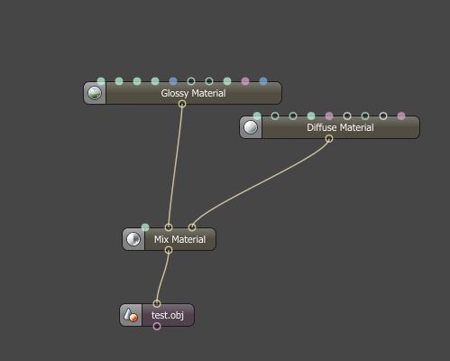

It is not worth uploading anything, it is so simple to recreate that I can just tell you how to do it.
1. open Blender, default cube will do.
2 setup the Octane render settings
3.start the render
4. setup a material like this
5. Save the project
6. Go back to blender and render again.
7. Now you get this
Sometimes one of the materials still remains. Quite odd.
