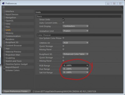

hi, what about changing the RGB range in the c4d preferences to 0-100%?
in theory you need only to add a math-divide node for getting the correct result

Anyway it doesn't help. Cinema colours must be Gamma correctet to get the Octane values.
Look at this cinema values are 1-100% (lower window) and it is still not the same
