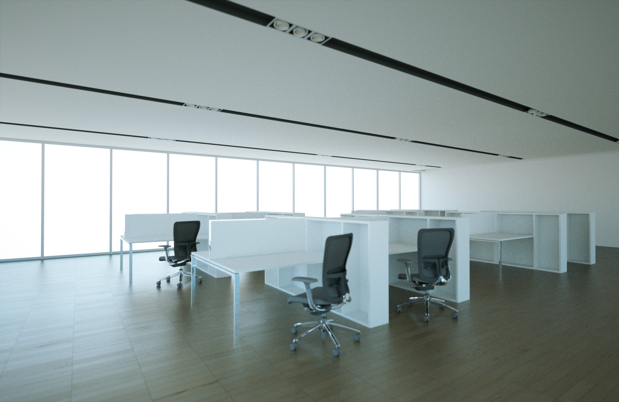

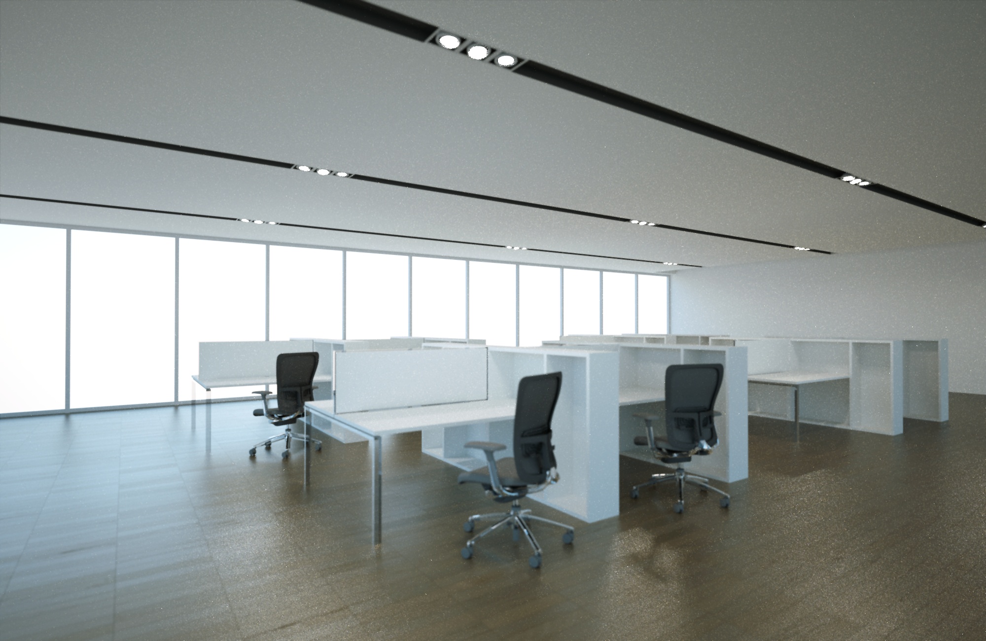

yes at least so it seems... .there's just some strange behavior in a table's leg, it seems transparent if i use "specular" material, even if opacity is set to 0.
I wonder if it's flipped itself, look yourself. Anyway, i dont know if it's of any meaning since the two apps may read OBJ in different ways, but if i import the exported OBJ back into LW, it has most normals flipped.
I attach bot the picture (look at table's leg on the left in picture with emitters - in other one i used a glossy material and it look ok) and OBJ so you can check.

legs are OK with glossy
legs seem transparent with specular material
