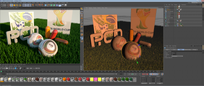

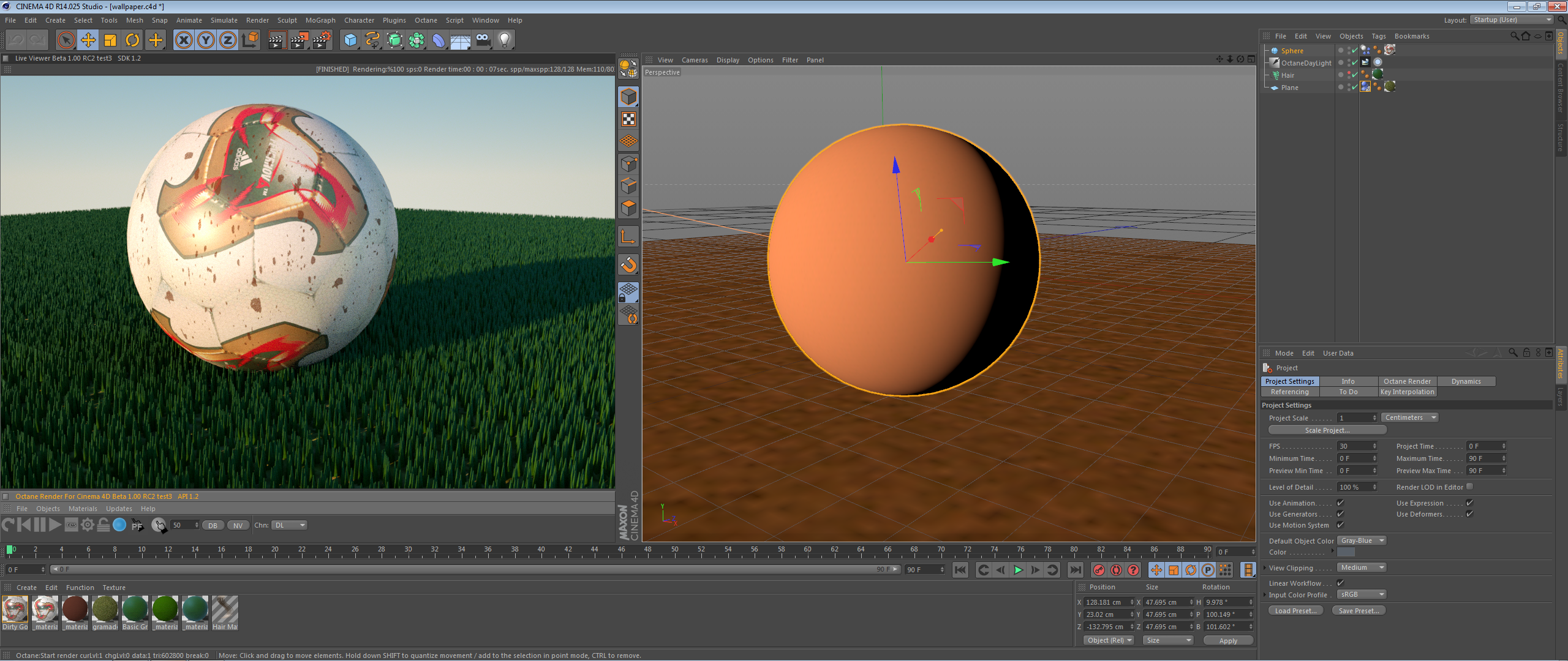

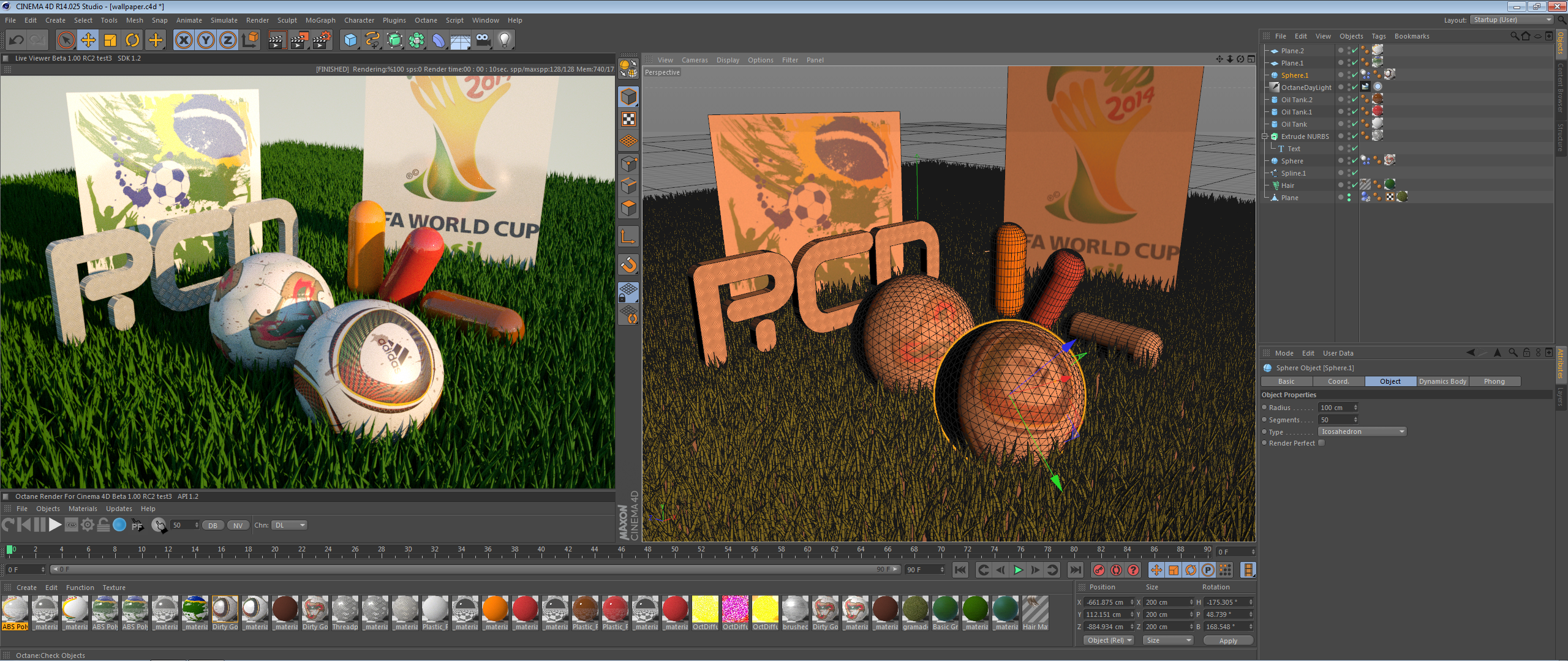

actually how to do grass in octane? can i still use hair?
picture from google

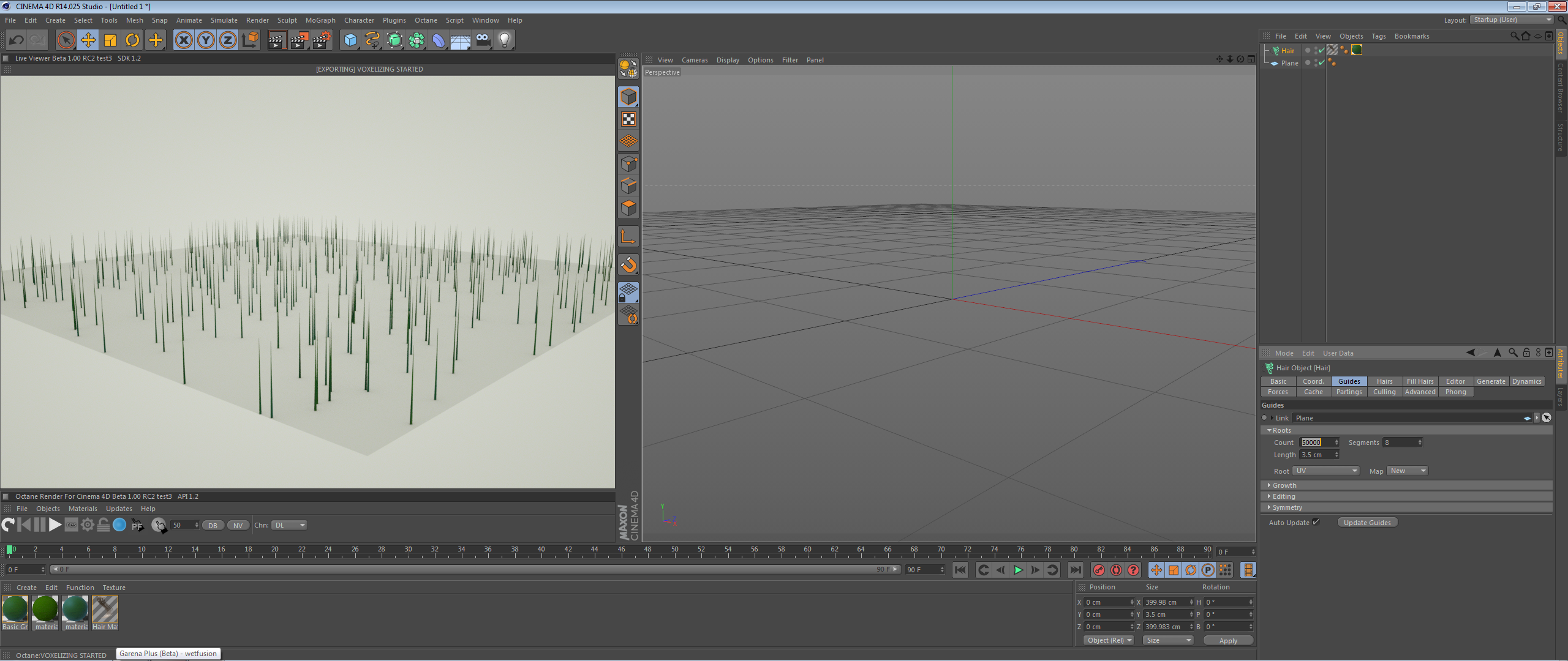

i give up. any tips for real looking grass? better a tuto :lol:

Hi Wetfusion,
It seems Hair works with Octane plug-in only with a polygons selection, not with a whole object in the link of guides. I don't know why...
This is the answer. Your plane is still parametric and then you have no polygon selection. In this case, the result is like yours in Octane. ;)
