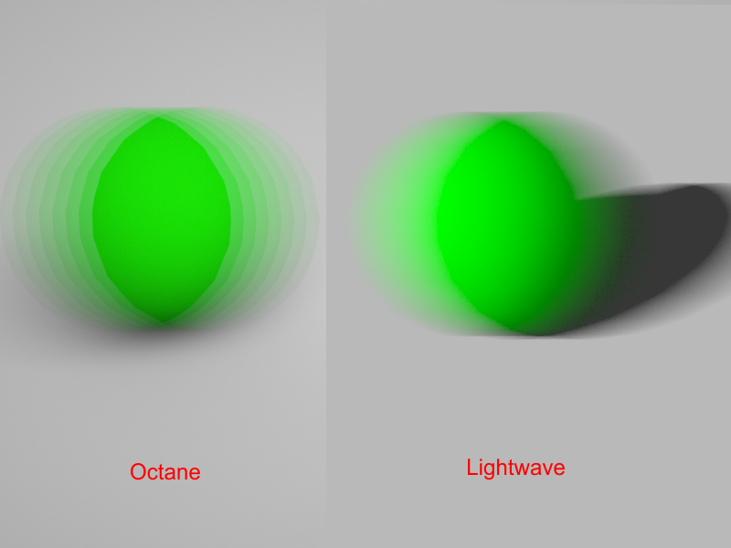

But if I got it right, your MB work like the classic MB in the Lightwave, this means if you want to get smoother result you have to increase a number of passes?
Here is an example:
right is a native LW render, 1 MB pass, adaptive sampling 0.01 min. samples 2 max 64
left is the Octanes one, 8 passes.
Does anybody know how to get same MB quality, like in the LW render without making a bunch of passes? Or it's not possible at the moment?
Thanks in advance,
Konstantin
juanjgon
Posts: 8867
Location: Spain
It is not possible at the moment, you need to use more passes to avoid the banding. Anyway if you use 12 or 16 passes the final animation looks nice.
This MB is only a workaround until native Octane MB is ready in Octane 1.5 / 2.0
-Juanjo
