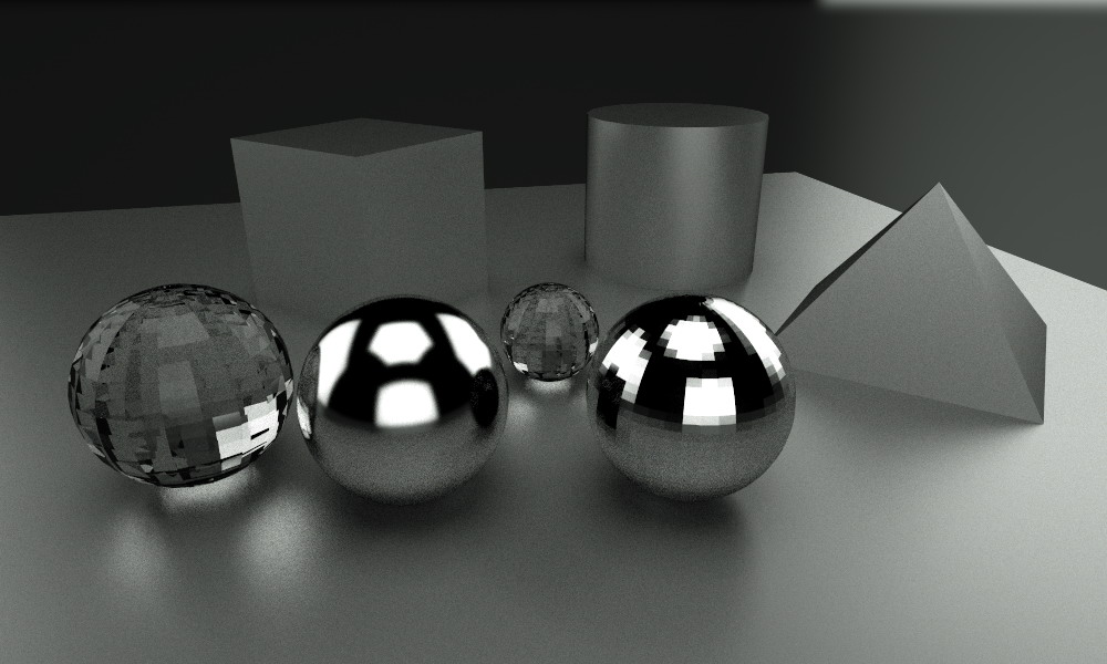

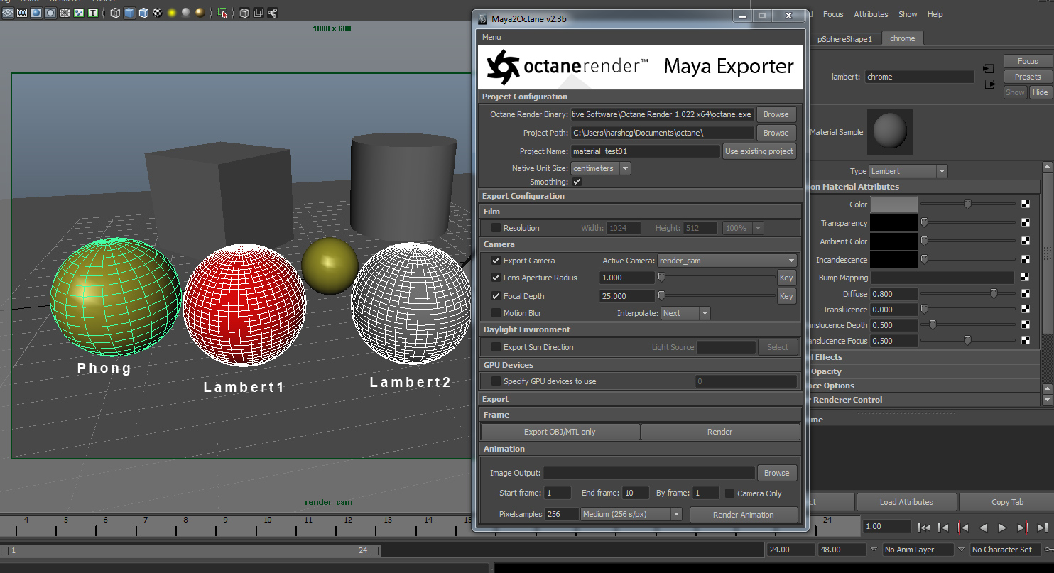

In my knowledgege octane can only understand different objects based on different shaders. So I applied one phone and 2 separate Lambert shader to spheres in maya, and use Export plugin for octane.
Its giving me facets on spheres, even though I applied mesh smooth to one sphere, and also checked smooth on plugin. It does that without smooth on aswell.
But it keeps the smooth for sphere in center, which has lambert1 shader.
Am I doing something wrong here? Or is it just inconsistent.
What other way can i apply new shader to an object, If all the objects have same shader while exporting from maya? Can i isolate objects based on meshes and not shaders?

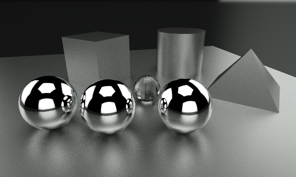

here I have applied same Lambert1 shader to all the spheres in maya.

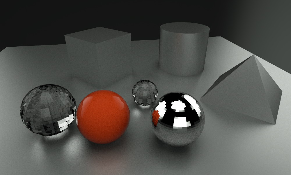

this is with first sphere having phong shader.<br />middle sphere having lambert1 shader.<br />and last sphere having lambert2 shader.

can u check in octane does some of these spheres have already turned on smoothing?

aah my bad..I'm still learning Octane. Having a smooth option in material for objects is great!

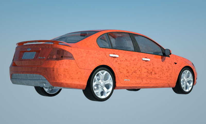

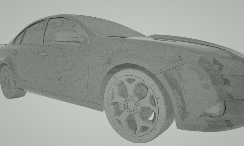

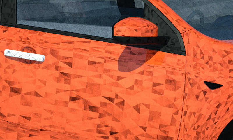

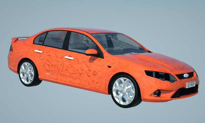

Also one more similar tessellation/facet problem I'm getting while exporting a car model from Maya. Tried turning on 'smooth' on this but it didn't work.
Any other cool tip to fix this artifact?
Thanks bazuka :)
tessellation/facets problem
facets fixed
facets fixed
