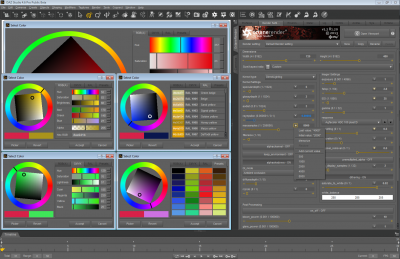

apart from lots of changes that happen under the hood, there are also some upcoming ui changes:
WHAT CAN BE SEEN HERE...
  • a new color swatch (apparently ;))
    of course being srgb / linear converted from/to octane
    • much better color picking by color ring and hue/brightness box (plus sliders and values of course)
    • live update to the according rgb spectrum node
    • rgb, hsv and hsl input, rgb hex text input, cmyk input
    • complete ral color picker
    • 32 preset slots
    • picker for screen colors
  • new value input module (sliders)
    completely done from scratch to match octane's needs, allowing much more precise input:
    • adaptive logarithmic range; means the slider scale stretches according to the value range
    • adaptive quantized steps when sliding or using the +/- stepper
    • mouse wheel stepping (not on focus but with rmb click, to avoid accidental changes)
    • tab key navigation to cycle directly through the values
    • up/down stepper for list values (like i.e. the camera tonemapping)
    • minor detail: since the hotpixel removal is likely to be misinterpreted,
      as 1 is no and 0 is full removal, the slider for this particular node is inverted
  • mode values saving
    • revert to previous value after changes
    • revert to the initial value (when the node was created/loaded)
    • memorize & restore a single value (per node)
    • add own often needed values (of course saved to disk)
    in addition i'm trying to utilize the daz studio undo/redo also for octane changes. this is rather complicated, but if once done, it will even allow to undo changes to the material structure (node connections) done in the nge.

SiliconAya wrote:Good to see!
Re the new colour picker, will we still be able to make/use custom colour presets?
I currently have 8 different shades of gray and a few other colours preset and it's a feature I use heavily.
yes; it's the bottom right of the 4 views; you can drag the current color from the preview area onto any of the 32 slots to save it...

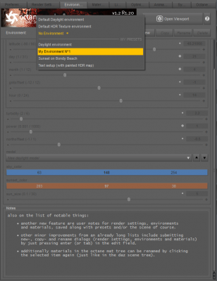

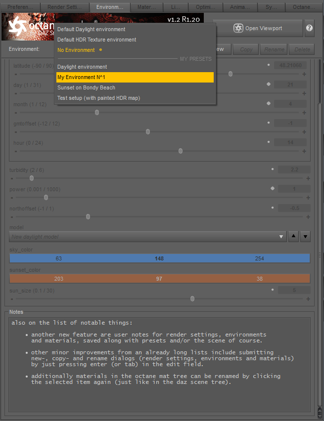

...more news:
user presets - finally;
i already mentioned it...
how it works - for render settings & environments:
- by using the copy dialog and ticking the "save to my presets" checkbox, exactly that happens
- user presets are at any time available from the according dropdown box (= without extra loading)
- selecting them from there will directly apply them to the scene
- when selected, they can't be edited (= grayed out, just like presets should behave ;))
- they can still be directly renamed and deleted, and of course copied forth & back into/from the scene
additional behaviors: most important is, that a scene won't keep a reference to a preset - if you save a scene while a preset is selected, it will be copied into the scene during save, otherwise deleting presets would of course alter other scenes that may use them also (if accidentally done - no problem just delete it from the scene).
this means you can switch between presets the same way as with scene settings/environments, seeing immediate results, and copy them into the scene if you like to keep them within. afaik this is as much straight forward and easy to use as can be.
note: user presets for materials, render settings and environments will be saved into a database that is created in your user profile (in the octane specific folder), means the settings can be easily backed up also...
