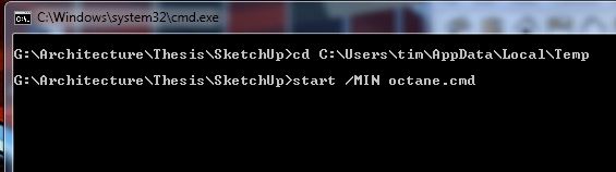

A test with a second model:
This time the .obj and .mtl are created successfully. Now when I try "Render Frame" I get the error message:
"Windows cannot find 'octane.cmd'. Make sure..."
However, it is in my designated TEMP folder: here's its content which looks OK:
@echo off
title Render Cmd
@"C:\Program Files\Refractive Software\OctaneRender_COM_intermediate_pre23_4_win_x64\octane.exe" -n "G:\Architecture\Thesis\SketchUp\XX.ocs" -l "G:\Architecture\Thesis\SketchUp\XX.obj" -m "XX.obj" --cam-pos-x -308.837616466608 --cam-pos-y 156.563068712856 --cam-pos-z 118.443524888825 --cam-target-x -255.030153855841 --cam-target-y 133.042408116701 --cam-target-z 97.2611494486325 --cam-up-x 0.350581556039049 --cam-up-y 0.926307118437628 --cam-up-z -0.138013386658749 --cam-fov 62.2358889220335
@exit
The screenshot suggests that the cd is not happening: the prompt didn't change.
I don't know how that could be...if I open a cmd window and do the cd and start manually, they work and Octane opens up with the correct model.
Mac Pro 3,1 / Lion / 14G RAM / ATI HD 2600 / nVidia GTX 470
i5-750 / Windows 7 Pro 64bit / 8G RAM / Quadro FX 580
Revit 2011, SketchUp 8, Rhino

TIG
Posts: 536
Joined: Wed May 12, 2010 1:25 pm
Tim
I see from the error reports athe there are two separate errors;
One is to do with the number of scenes in an animation [#1884] - perhaps you only have one ?
Try adding one or two more scenes and see it that error goes
I can see a fix for this and it's in hand...
The other [#2752] is to do with having an image in the model -it should be trapped and export properly - I can also see a fix for that too...
Try exploding the image into a face or hiding it/putting it on an off layer - it should then work...
So it's nothing to do with your setup more glitches/typos in my code that combine when you have a certain scene count and images in the model
When these are fixed I'll post an update shortly... Look out foe something new soonest...
TIG
TIG
Posts: 536
Face
Spaces in file-paths are OK - they just aren't allowed in file-names [ocs/obj/mtl].
TIG
