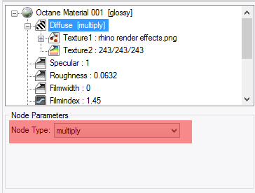

Simply pick the multiply node from the Node Type - and that node node gets added to the material and plugged into the pin you picked.
- Attachments
- rhino multiply.png (11.64 KiB) Viewed 6669 times

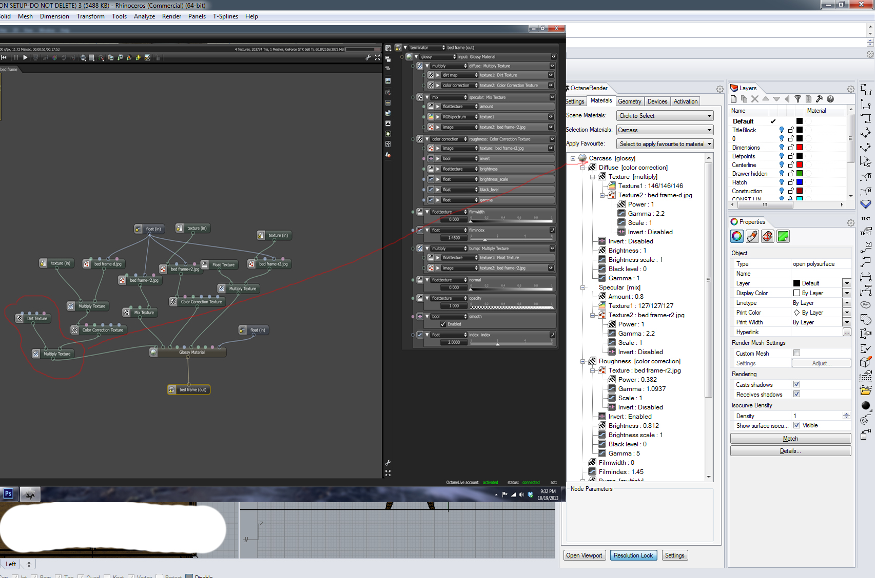

Hi Paul,
Yes, thanks, I understand (and am using that) function, but is there a way to duplicate the diffuse pin? That way I can duplicate the pin and then add my preferred node (i.e. multiply) to my existing material?
Otherwise, is there a way to save a material in the stand-alone and import it into the Rhino plugin? (I don't want to have to save it to the live DB and import it into Rhino (which works great--thank you!)). Could this function (importing personally saved ocm's (not in the live DB) created in the standalone) be added to the plugin functionality, if it doesn't already exist?

It's not possible to have two diffuse pins on a material (in Octane Standalone or the plugin). To add your preferred multiply to an existing material, select the material, click the diffuse pin, then change the node type to "multiply". Can you post a screenshot of the Standalone structure you are trying to achieve?but is there a way to duplicate the diffuse pin? That way I can duplicate the pin and then add my preferred node (i.e. multiply) to my existing material?
That's not (currently) possible, and shouldn't be required. It will be much quicker to edit the material in the Rhino material than Standalone.Otherwise, is there a way to save a material in the stand-alone and import it into the Rhino plugin? (I don't want to have to save it to the live DB and import it into Rhino (which works great--thank you!)). Could this function (importing personally saved ocm's (not in the live DB) created in the standalone) be added to the plugin functionality, if it doesn't already exist?
Paul
Click on your "Diffuse - [color correction]" pin, Copy, then change it to a "multiply", the select "Texture1" of the new multiply an change it to "dirt" and select "Texture2" and Paste.
Paul
