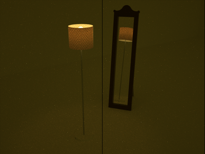

Lamp with bulb (emitter) and a mirror to help see addition perspective.
The inside of the lamp shade is not lit, for both path tracing and direct lighting renders.
Resolution: 1024x768 at 2000 samples, for both renders.

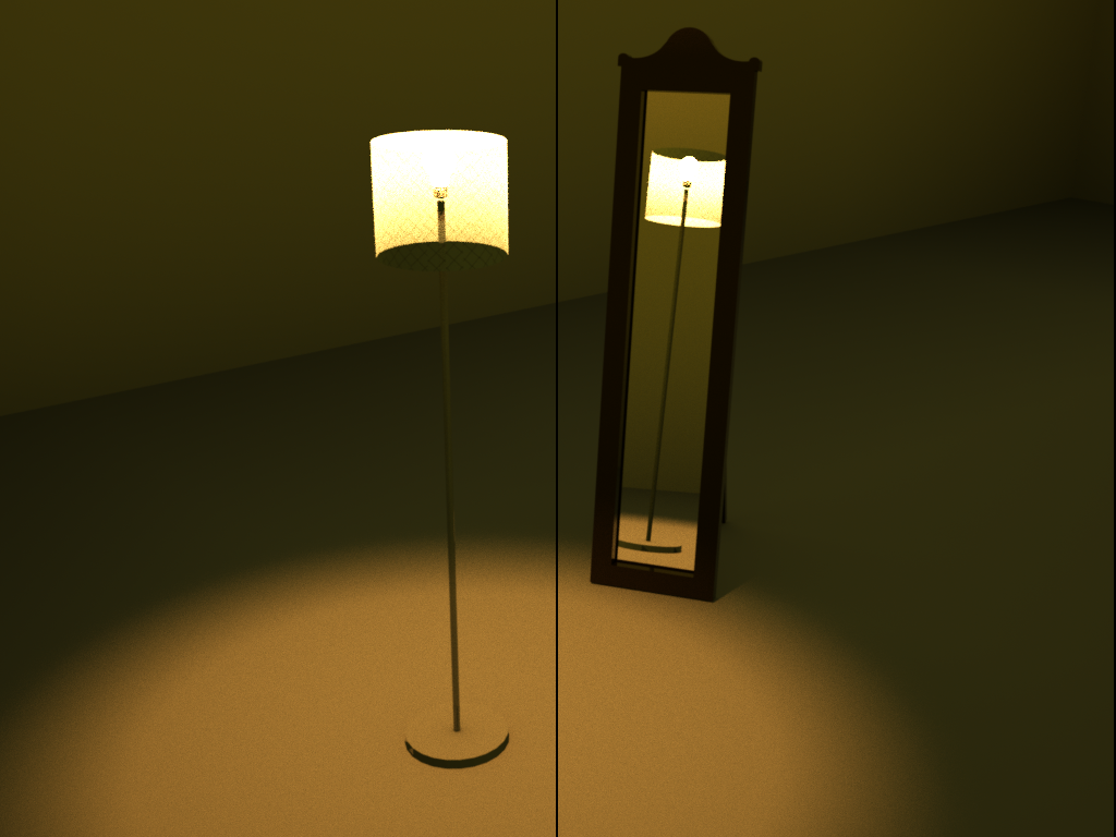

MaTtY631990
Posts: 754
Joined: Thu Apr 08, 2010 8:38 pm
Heres a workflow, In the graph editor make a diffuse material and connect to your lamp shade and then make a RGB spectrum texture and connect to the transmission controller on diffuse material and set to pure white. You can only see the real effect in pathtracing. ;)

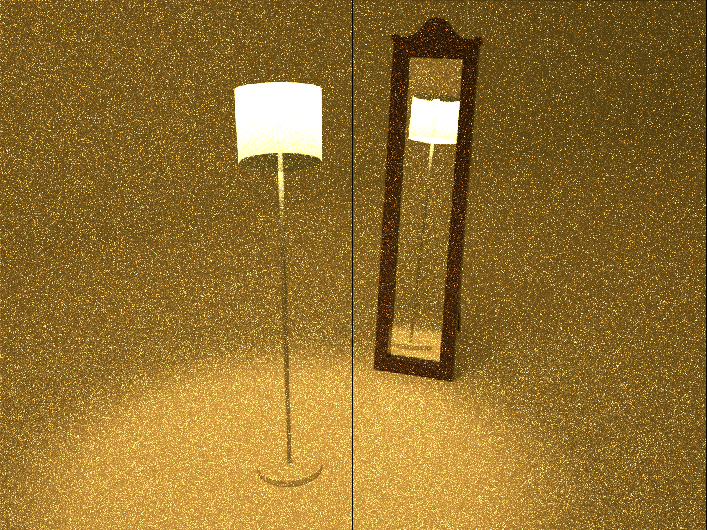

MaTtY631990
Posts: 754
So the output is from RGB spectrum is connected to input on transmission controller, and the diffuse material is connected to your model replacing the lamp shade material that was their, and leave the colour set to default and change transmission colour to white. Set your rendering kernal to pathtracing and this is result you should end up with.

watchyour6
Posts: 19
Joined: Sat Sep 04, 2010 6:38 am
Much better! Thanks again for the tutorial!
