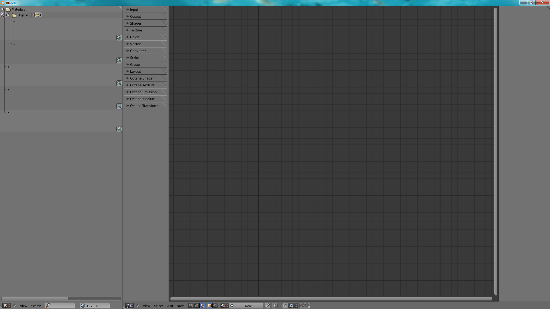

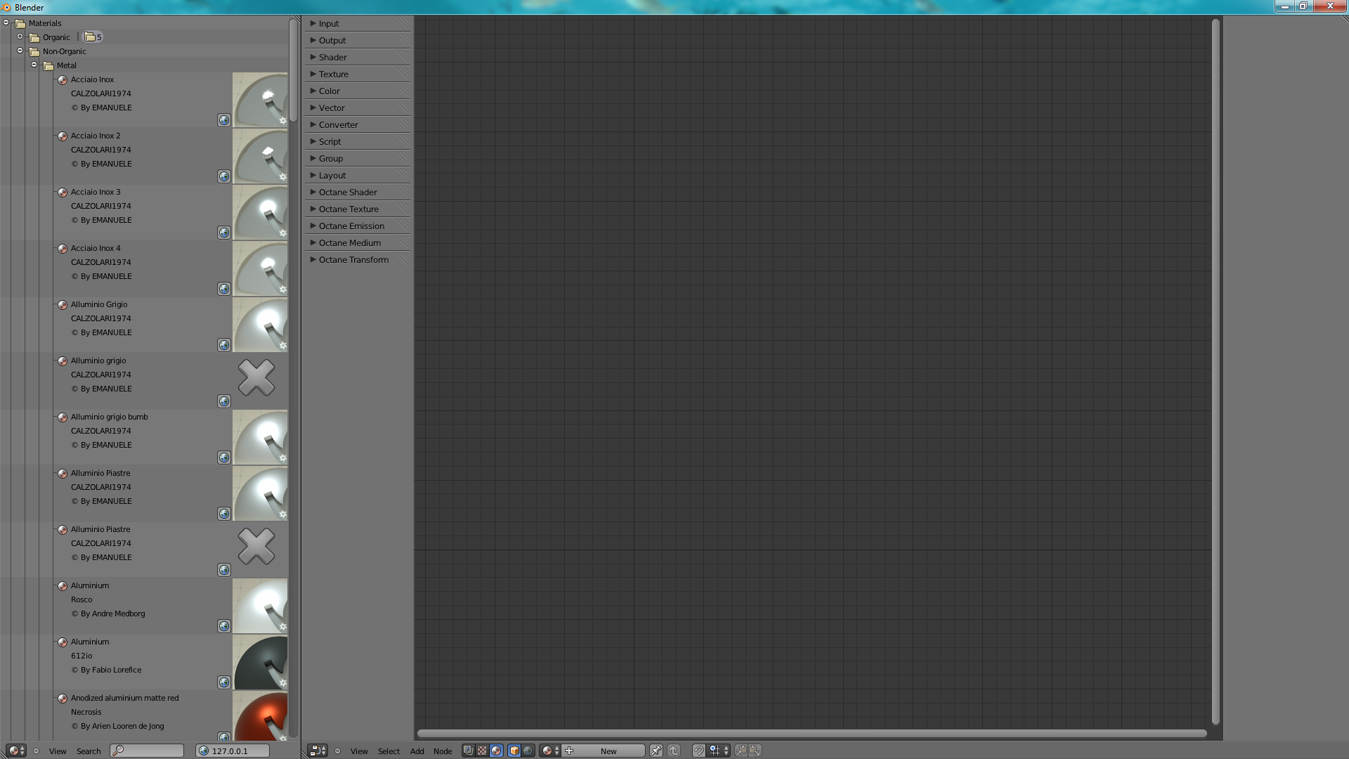

This is really low priority, but I found something. The following image shows the Live DB window within Blender.
Before delete...
Before delete...
If I right-click on one of the items that has an X and select Delete, the tree view goes a little crazy as per the following image. Again, very low priority, but I figured you might want to know about it.
After delete...
After delete...
-Dan
AMD-1100T 6 core, GTX-590 & GTX-480 1.5GB, 16GB 1600MHz RAM, 1TB WD 6GB/s, Win7 64bit, Blender 2.68a for Octane 2.2, Octane 1.20, Blender/Octane Server 2.2
JimStar
Posts: 3852
ephdot
I already wrote somewhere earlier: all the editing operations on the LiveDB materials tree are just stub for future "local database" feature.;)
Yes, when I coded the LiveDB, I've taken into account all the future things, so I've added the "in place" renaming, and context menu invocations... But it is not supposed to work at the time, I've just stubbed all these operations. As there is absolutely no sense to alter or remove some item, as after every tree refresh the state will return to the exact state of currently choosen LiveDB source (only OctaneRender LiveDB server at the time).
