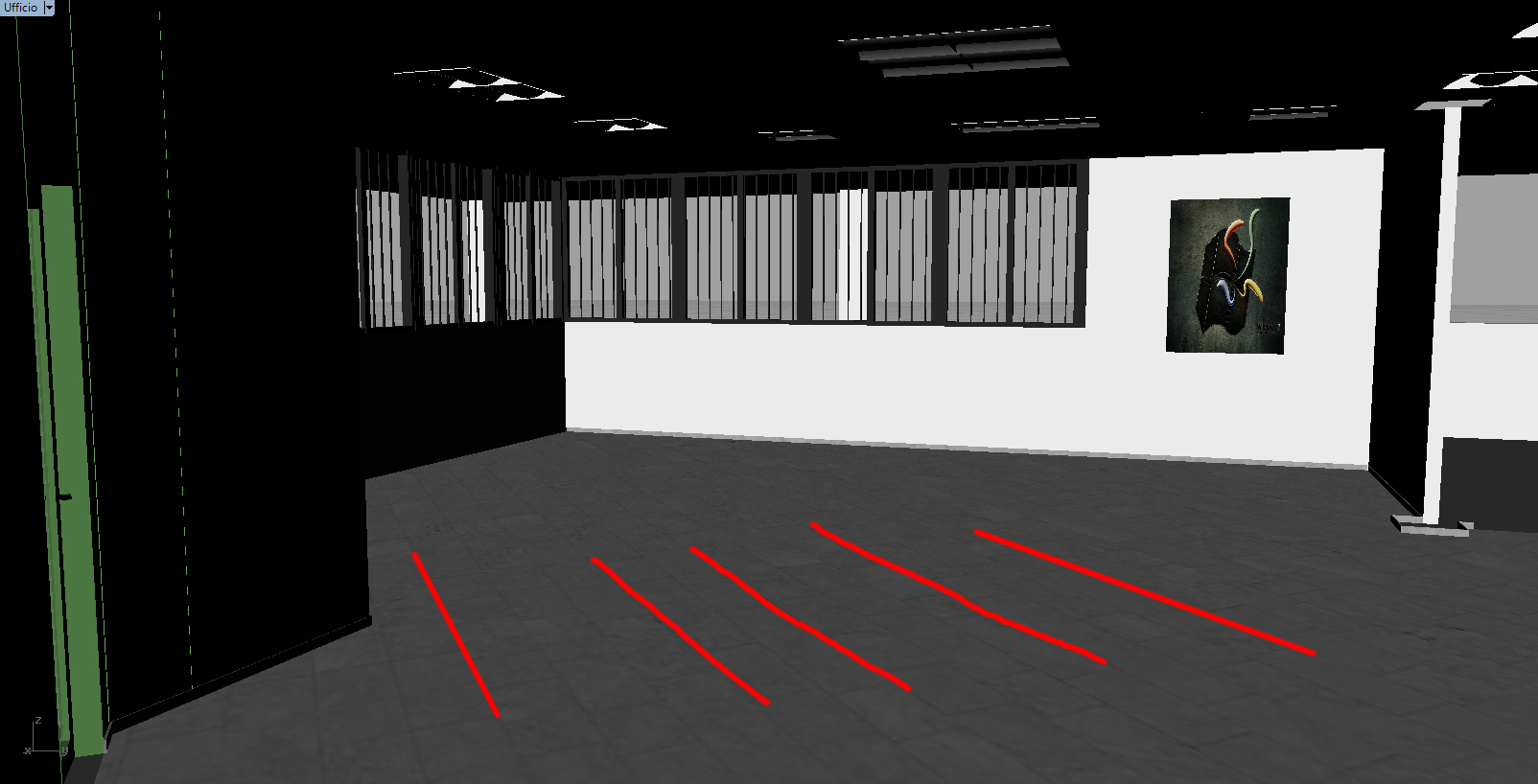

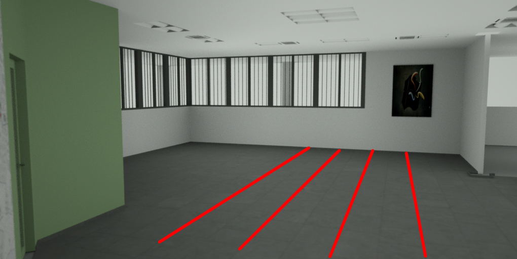

Sorry maybe i found a bug...during export my UV map setting lost..i add image.
The true or false setting for each card determines if Octane is told to use the card or not. If all cards are false, then nothing is passed and Octane decides on its own what to do. It appears that in certain situations Octane doesn't like being told what to do. I have added this to the bug list and it should be a quick fix.
As for the texture mapping, how did you apply your mapping in Rhino? Unfortunately I am entertaining the in-laws this weekend, so I will have to look at this on Monday (as well as the card selection bug).

To Sampage:
I use "plane Mapping" in rhino v5
