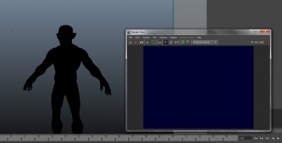

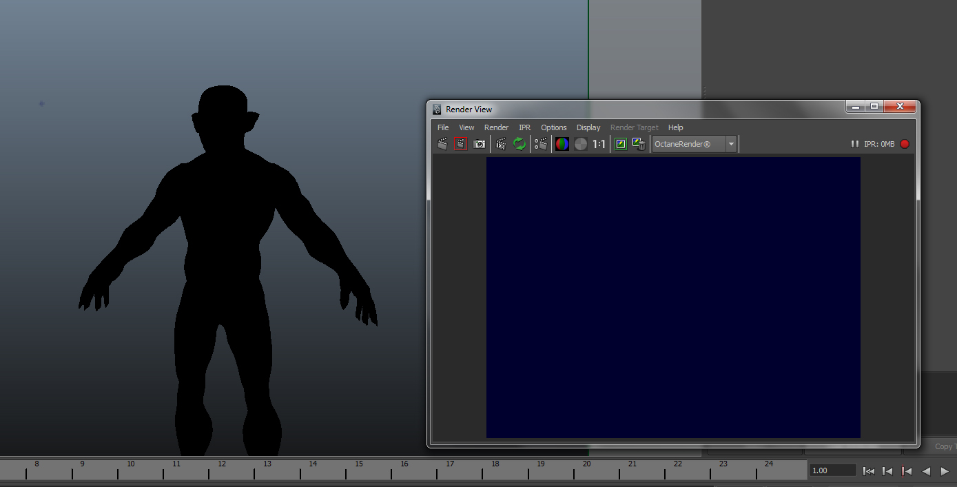

this is what i get when i try the plug in. everything is loaded correctly including the standalone app

Please enable the "Verbose mode" in Octane global settings, and look at console messages...

I just enabled verbose mode, where are the console messages located?
*if console is the same as output window, im looking at it now, but what would i be looking for?
I have a light in the scene, and an octane camera and an octane material assigned to the geometry
The standalone app works, I tested it with the same geometry, what could this mean as the renderer idles on the default blue sreen?

Console - I just mean "Maya Script Editor".;) It is where you get all the messages from Maya.

ok this is what came up in the sript editor, not sure what its telling me though.

g0ll4m wrote:// Warning: Octane: No CUDA devices choosen to render on. Rendering on the first one: Quadro FX 4800 (compute model 1.3) //
Here is the reason. Too old CUDA compute model...

how is it that the standalone app works but the maya plugin doesnt?

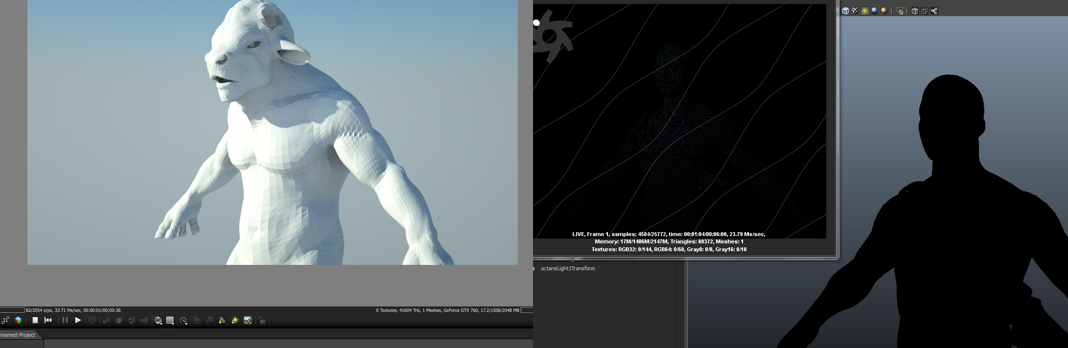

ok, it works now, i swapped out my graphics card with a new one. The standalone app renders ridiculously fast, but the maya plugin i can't get similar results,
i have a light in the scene and i tried adjusting the max samples size but it still looks the same, it barely shows up through the renderer.
am i missing something?
nevermind, i needed an environment and i guess im using the lights improperly
