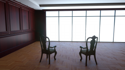

I'm trying to learn Octane at the moment and I'm running into some unexpected results. I've got four GTX Titans and I'm having trouble getting good render times. It has to be my fault, right? See the attached frame. This is a very simple interior, with barely anything inside, but it's taking 2 minutes per frame to get to 5000 samp/pix at 1280x720 and its still VERY noisy. Can someone offer some advice on how to reduce render times and noise? I'm using OctaneDaylight with a large portal in the window. I HAVE to believe that 4 Titans can do markedly better than this.

It takes me several hours to get to 5000 samples.
Octane render isn't instant!

Remove portals. You have big enough windows.
OctaneDayLight? I don't see any sun light there. Use texture environment.
Use PT if you are using PMC.

Titans aren't that fast... they're slower than GTX 590 from the 80´s :lol: , they just have much more memory... :D
And in pathtracing you need 4 times more samples to double the signal to noise ratio, so it means that you need 4 Titans to have half the noise you have with 1 Titan with the same render times...

cook it longer
16000 Samples should be fine

Or render bigger, resize then and the small grain is gone.

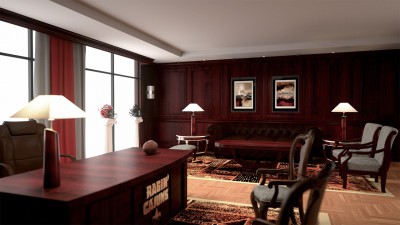

Hi guys. Thank you for all the replies. I finally decided to use an old V-Ray trick to speed things up - put a large light in front of the window and remove the physical sky. By doing that, I was able to get render times down to around 30 seconds for 1280x720 with an acceptable noise level at 1000 samp/pix
Attached is a rendering I did at double resolution which took less than 10 minutes at 2000 samp/pix
manalokos, I bought the Titans because I need the extra VRAM, but thanks for crapping all over my new gear!
I was able to render out a 30-second animation of this room in several hours. I'll post the video tomorrow.
