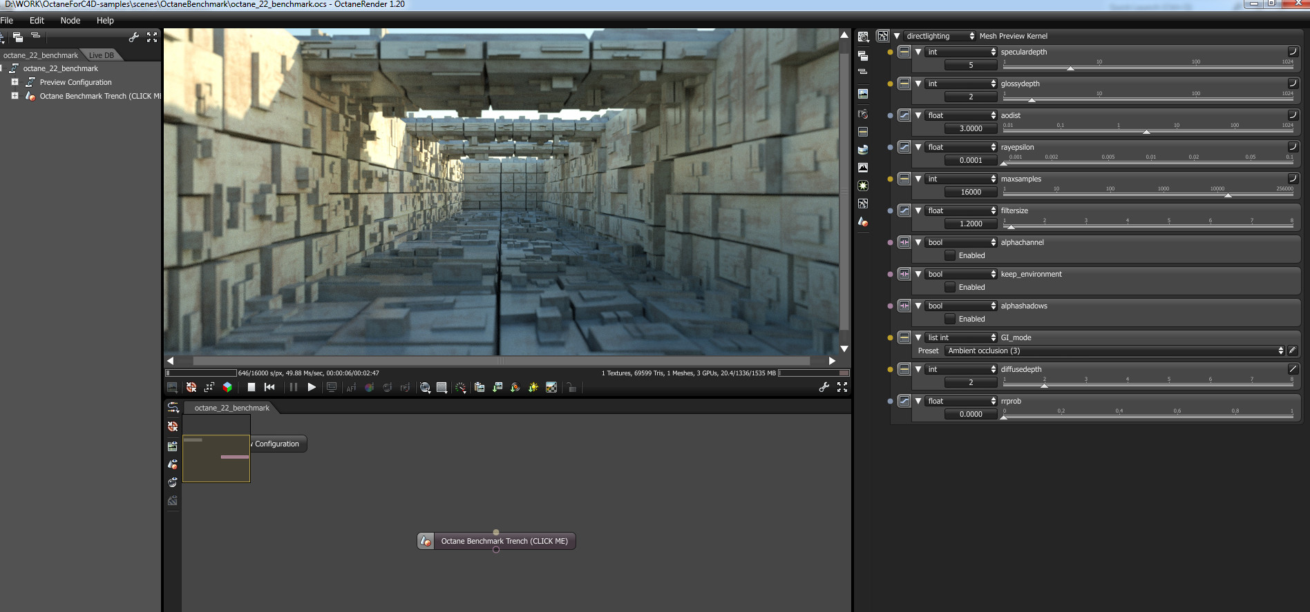

I know it should not be compared, but why there is such a big difference.
  • Oc Standalone computes 5.04Ms/sec
  • Oc via Cinema plugin (low_priority) computes 2,56Ms/sec
  • Oc via Cinema plugin (high_priority) computes 2,84Ms/sec
All parameters were reproduced in the identical or the most similar way. So than, why results are different, in the overall look and the speed in standalone is 2× faster than via Cinema?
Should I move back to standalone :?: :?: :?:

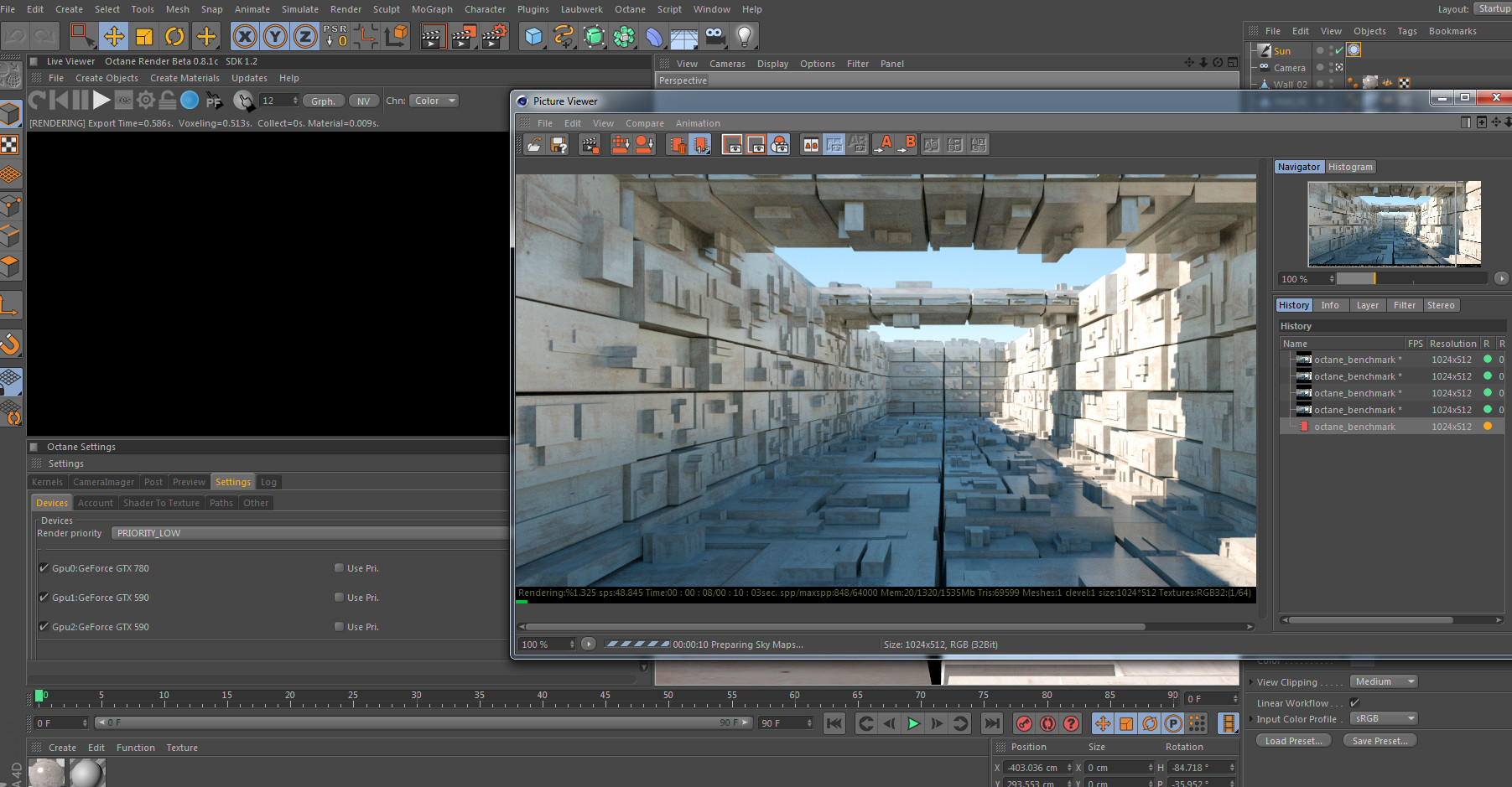

i'm curious that speed difference is enough to leave this plugin ;)
i'm sure you doing something wrong!!! look my pictures
Posts: 16068
Location: Türkiye
ok, i found. Scene scaling is different on scenes.
group all object and try to group with factor 100.0
Check your dimensions of objects. They are 4.5cm only. Try to change 4.5 meters.

Scaling ×100 helped :) now Cinema calculates 4,7Ms/sec
There was also New Model checked on in the Daylight Tag Sun setting, which changed the colour.
