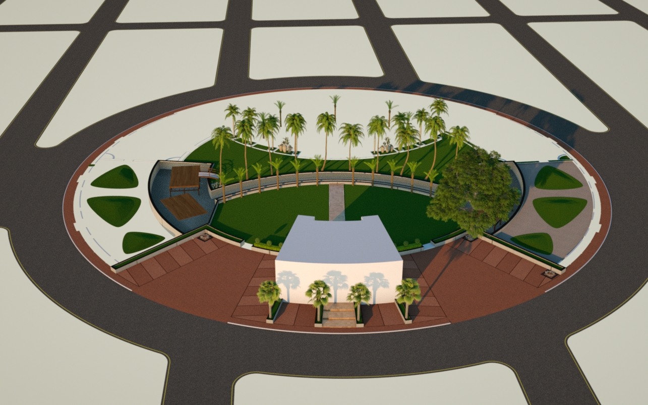

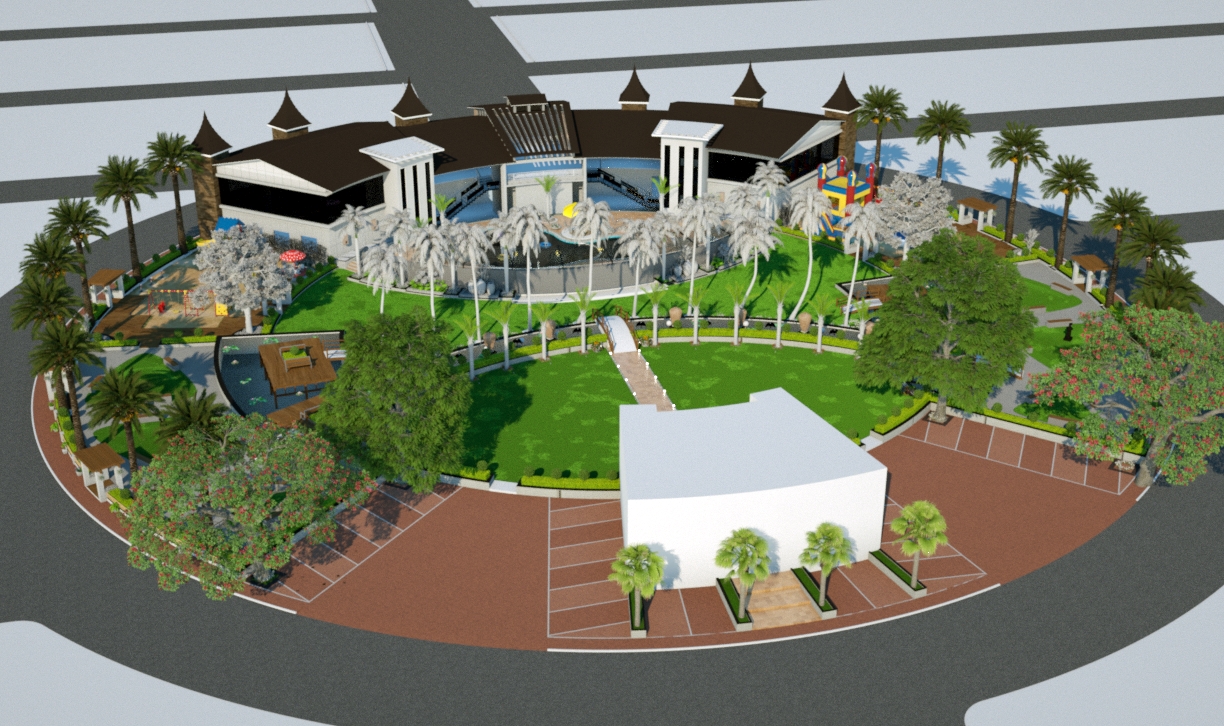

Hello Friends,
I am very new to Octane render and currently working on a project in 3ds max
The Problem i am facing is: when i render my whole scene in Octane many of the materials (already octane converted) goes missing and each time i load missing materials changes randomly.
But when i isolate the same objects it renders completely fine. You can see in the attached image the textures of the palms goes missing, while it render when isolated..
Please help :(
currently using GTX Titan .. Software: max 2014, Octane 1.20
after isolate
after isolate
full file
full file

ghm, maybe You just have too much materials =) and loading is in some sequence that leads last materials to by missed? have You checked the count?

Oh, is that so? Can u elaborate? My mesh count is about 13 million+. Is it the issue?
Do u know what are the limit of texture? Thanks for the reply by the way :)

HI noelnoel, akira and glimpse...
I Just found that we have used 542 texture and the limit is 144 texture...
Can you help us out with your tips & tricks...
