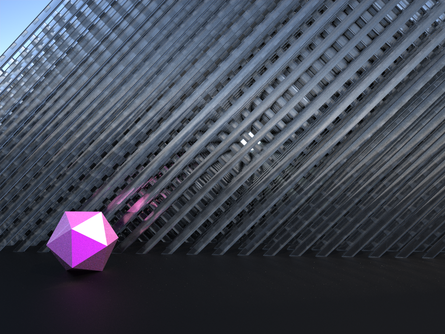

This is a test scene I created for Maxwell a while ago. Octane gets to "voxelizing..." and then my whole computer freezes and my disk buzzes rhythmically.
The forum won't let me upload the file, it just uploads then reloads to a blank newtopic page.. I've uploaded it to http://kano.net/in/latticemaxwell.zip
Here's the maxwell render, excited to see the Octane one once this is fixed

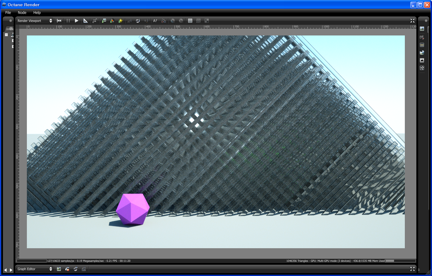

I tested files, you uploaded, and noticed it is needed more then 9.62GB of RAM to perform voxelizing.
And following image is the result of 11 min 20 sec.
And, the 60 min's result.
