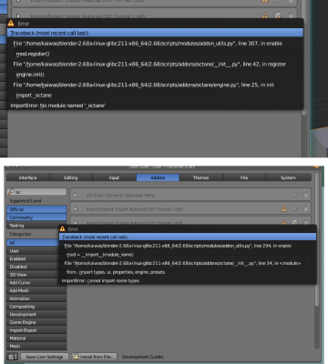

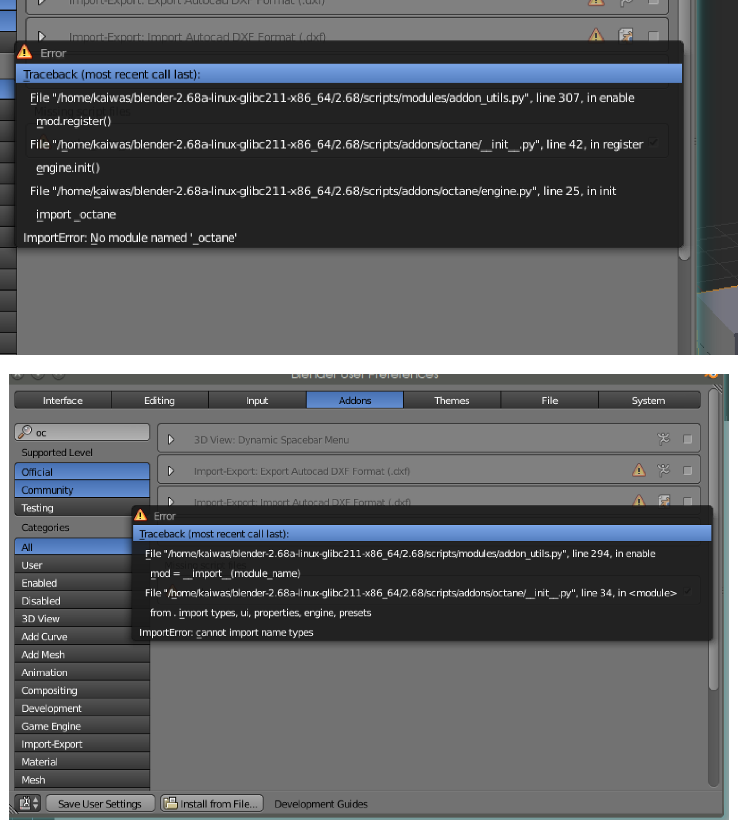

don`t work
JimStar
Posts: 3850
kaiwas wrote:don`t work
Do you have the "types.py" file in Octane addon folder? It seems that it is missing for some reason... Check it please.
JimStar
Posts: 3850
And are you sure that you run it from the right installation?.. As I see the folder name is "blender-2.68a-linux-glibc211-x86_64", perhaps you have mixed the two blender versions, plain 2.68a and Octane edition 2.68 somehow?..
kaiwas
Posts: 44
Joined: Thu Jul 11, 2013 7:35 am
Yes. It is present. Files are aligned with the subject of the directory tree.
Thank you! The problem in this
UPD/ 2.68 does not solve the problem
UPD2 / Blender from the source archive is also not start. therefore combined the two "versions"
