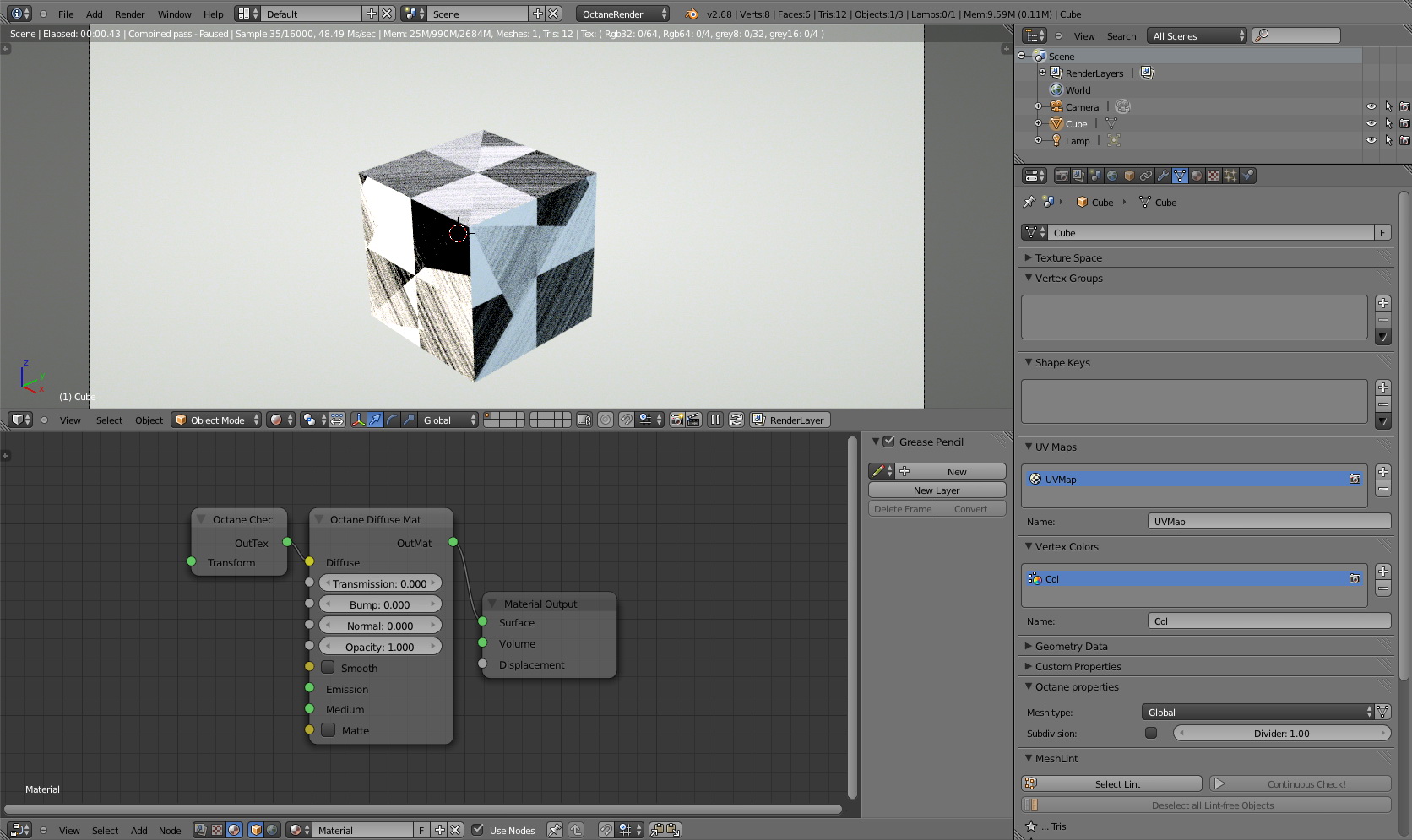

Checkertexture looks wrong:
Here is the Blendfile:
Cube_Test_00_190813.zip
(77.61 KiB) Downloaded 415 times

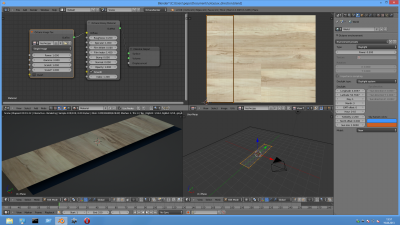

I think I've just found a bug. The direction of UVs appears to be 90 degrees to the way that Blender is showing them. i.e. I unwrap a plank of wood so that the grain is going along the plank but when I render it the grain is across the plank. Obviously this makes accurately unwrapping objects impossible.
Can anyone else confirm this?

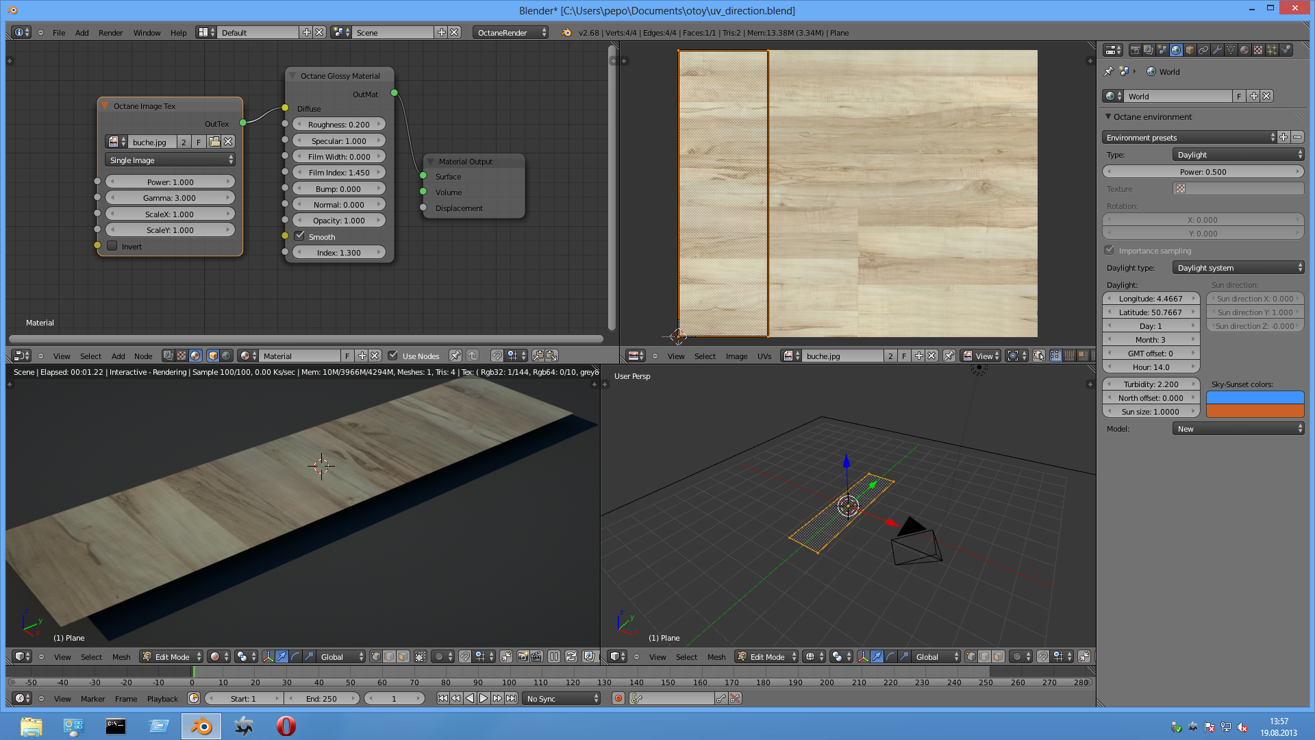

Hi steveps3, no I cant.
Screen shot with unwrap from view for simple plane.
Cheers, mib.
