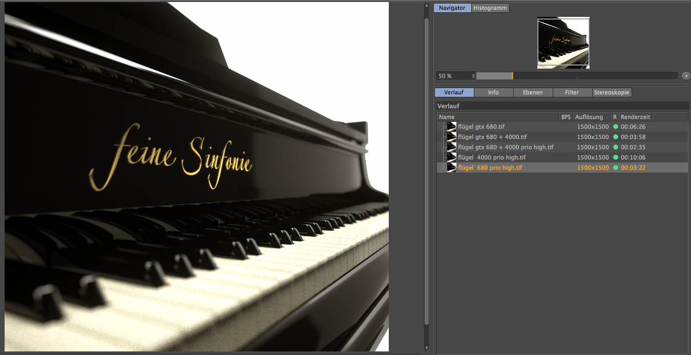

hi - i am on a mac pro 12 core 24GB - mountain lion
first i used an official mac nividia card - the quadro 4000
then i bought one week a go an gtx 680 4GB (from america over internet) - and wow it cost only the half of the quadro - and have - i think more then double of the power to render
i attached a screenshot from a test - with only one card and both togehter and with prio checked.
it is not really safe that i use both cards in one mac - because the power supply for the PCI slot normaly only give 300 watt - my both cards have under full work 349 watt
so i think i take out the quadro again and put in my older mac pro and get a smaler card only for the monitor - but it works.
