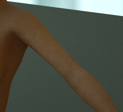

when i try to render animation, there appear lines between body parts (chest, shoulder, forearm etc.) if no morph injection applied, there is no crease, but once morph injected there appear cracks. how can i fix this? please heip me !

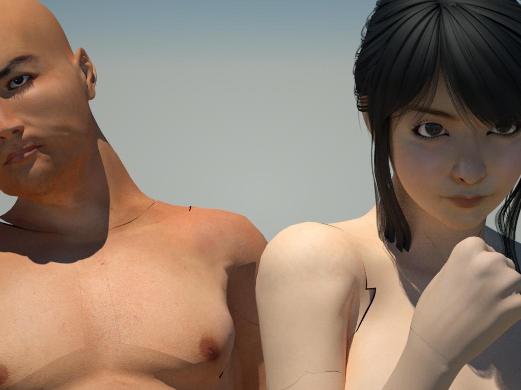

ryan and v4
ryan and v4

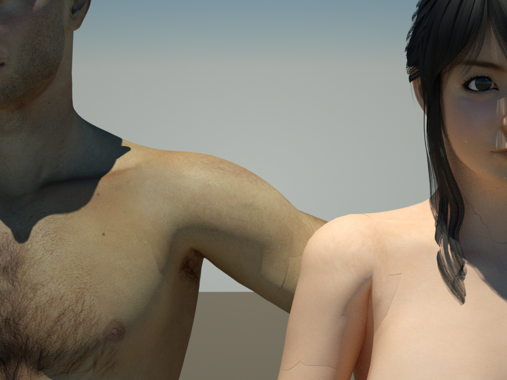

m4 and v, Lt is onctane viewport, Rt is poser viewport

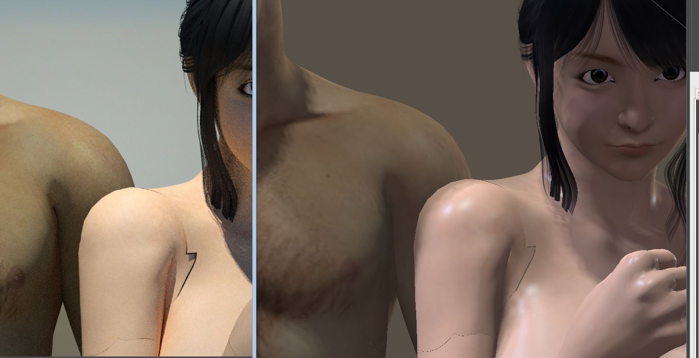

m4 and v4
m4 and v4
