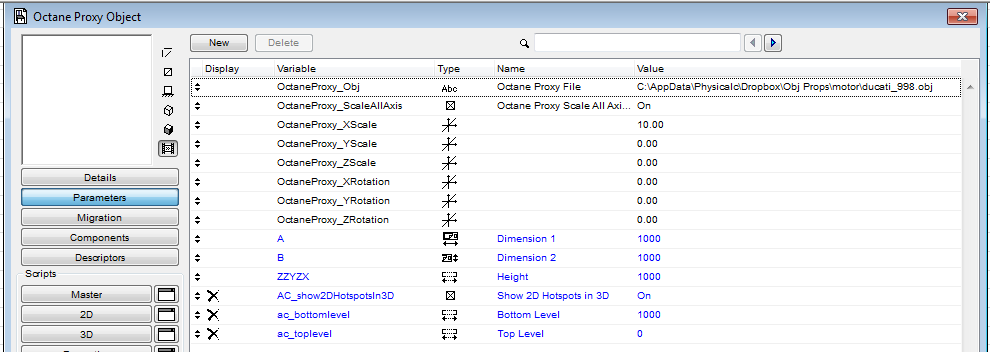

- HIGHLY EXPERIMENTAL! If you have not assigned a proxy to an Object, and the Object has an "OctaneProxy_Obj" GDL parameter, then the "OctaneProxy_*" parameters will be used as the defaults to convert that Object to a proxy. Once converted, use the standard proxy dialog controls to adjust the settings (the "OctaneProxy_*" will be ignored after the Object is a proxy host). The parameters are....
"OctaneProxy_Obj" (Text) = the full path and filename (incl OBJ extension) of the OBJ proxy file
"OctaneProxy_ScaleAllAxs" (Boolean)
"OctaneProxy_XScale" (Real Number)
"OctaneProxy_YScale" (Real Number)
"OctaneProxy_ZScale" (Real Number)
"OctaneProxy_XRotation" (Real Number)
"OctaneProxy_YRotation" (Real Number)
"OctaneProxy_ZRotation" (Real Number)
(see screenshot below). This means in theory you could build up a library of GDL proxy objects, which could be a huge time saver. However my ArchiCAD skills are wanting, so I found this system a little clunky to use, but hopefully it will address John's requirements in this area.

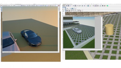

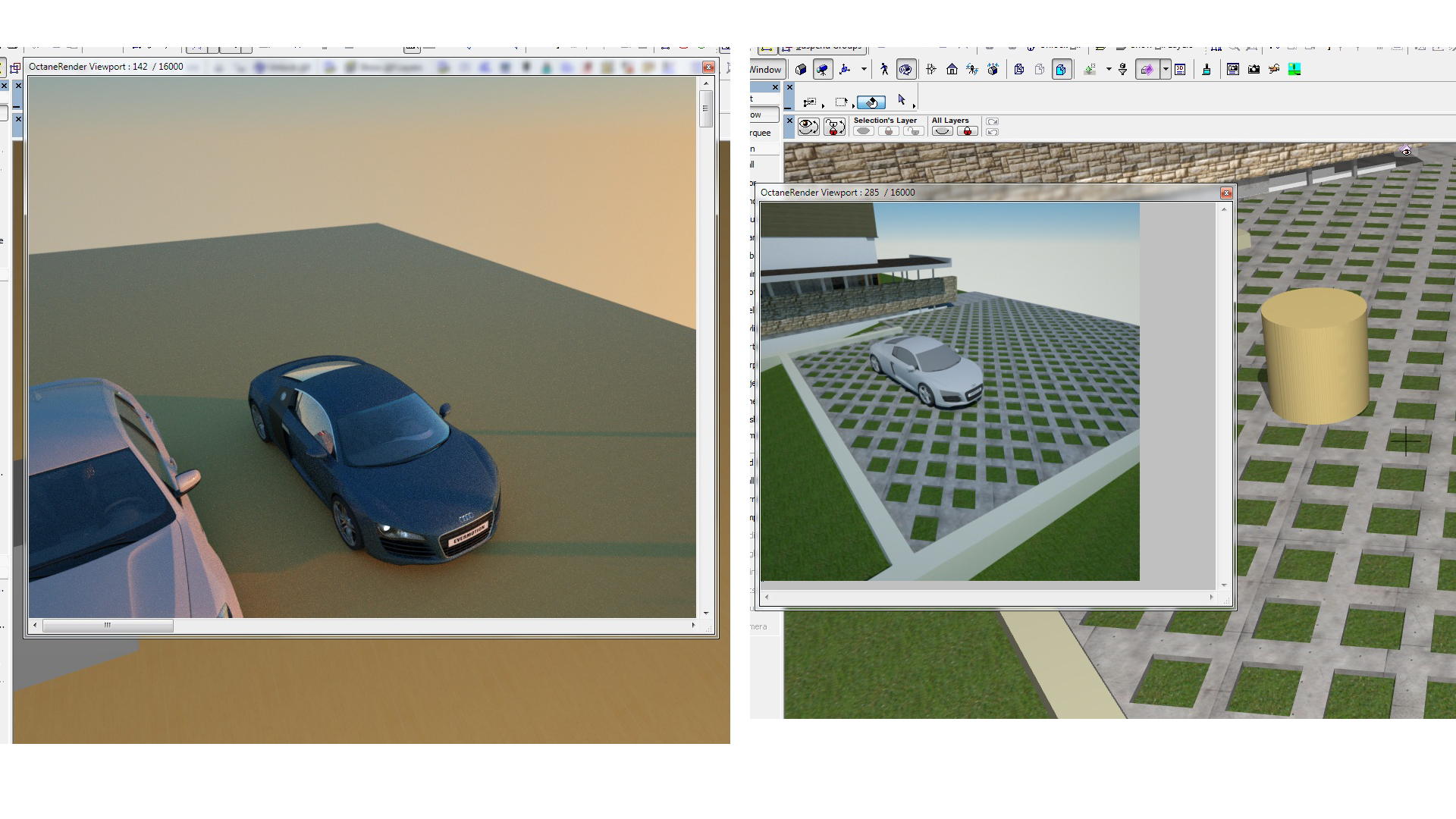

Hi Paul,
This new copy-paste is really cool! Thanx for implementing this feature.
I also tried this: copying AC object with proxies assigned and paste them into another empty pln that is open at the same time. The nice thing is that it copied the objects with the proxy already assigned!!! That is super. Only it did copy it to only one AC Object when having moe AC objects assigned with the same proxy?
And indeed... it is better to copy and paste the proxy settings, because two times I had a quick Archicad quit when trying doing that with the OR Viewport open.
greetings, Jeroen

rappet wrote:Hi Paul,
greetings, Jeroen
Hi Jeroen. Can you pls send me the crash report? I thought I stopped the ability to copy from one scene into another, but it appears not! In theory it should be ok. Did you get the crash when copying from one scene to another, or when copying within the same scene?
Paul
