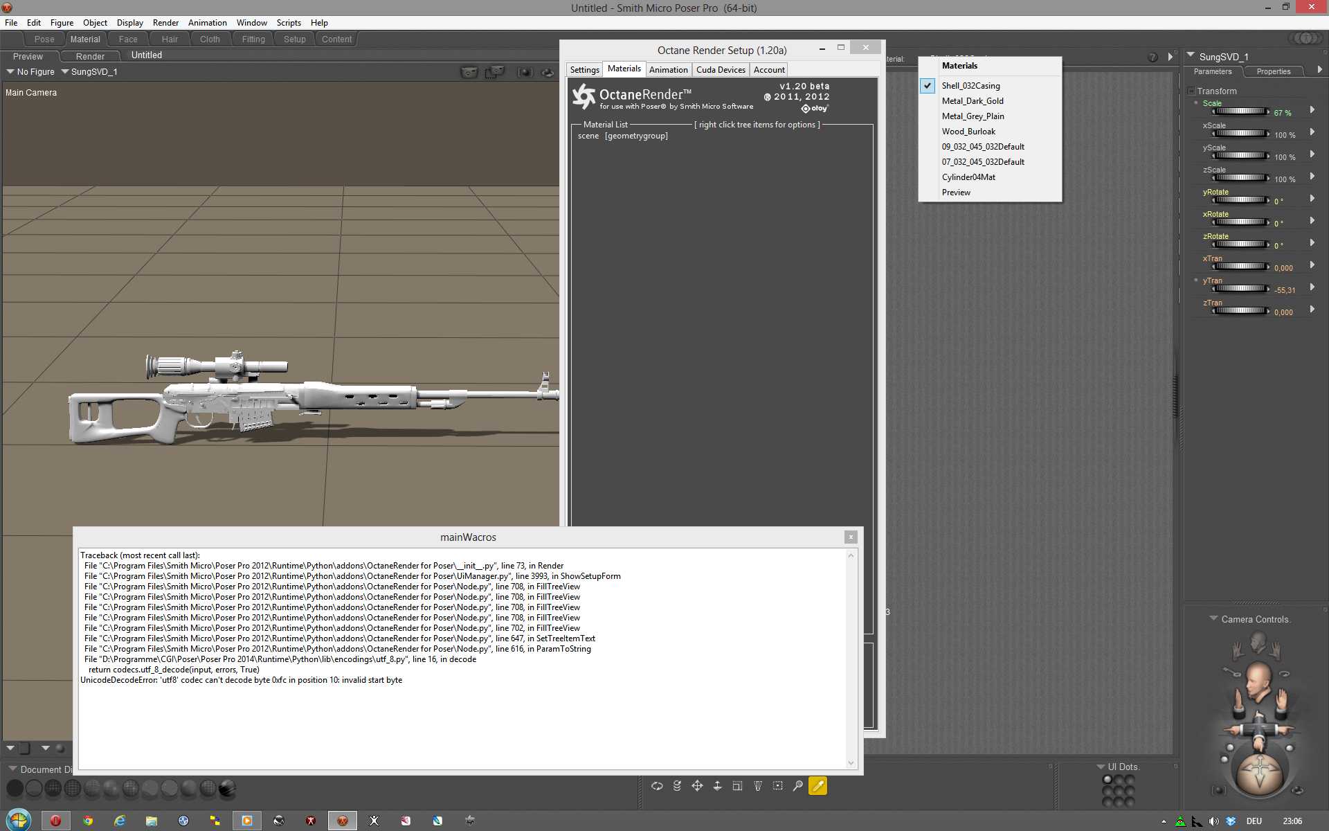

another weird object:
I get this error when trying to load that prop. I worked with it before and saved it with Octane materials exported back into Poser. trying to load it fresh ends with this messages:

thought, it might be because of a strange material name, but it doesn't seem so:
Hi Uwe
That error is actually coming from special characters in the image map of the Octane node setup for one of the materials. I will fix this in the next day or so.
Paul
