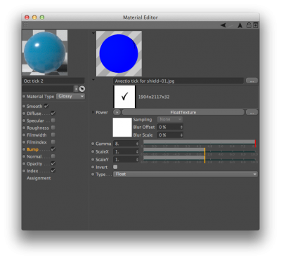

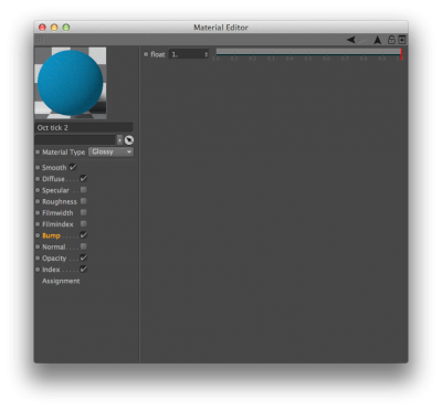

Thanks for the help but still really struggling to change the depth....
Dont ask me why but my client wants the tick in the back of this shield to have a depressed or debossed look to it.

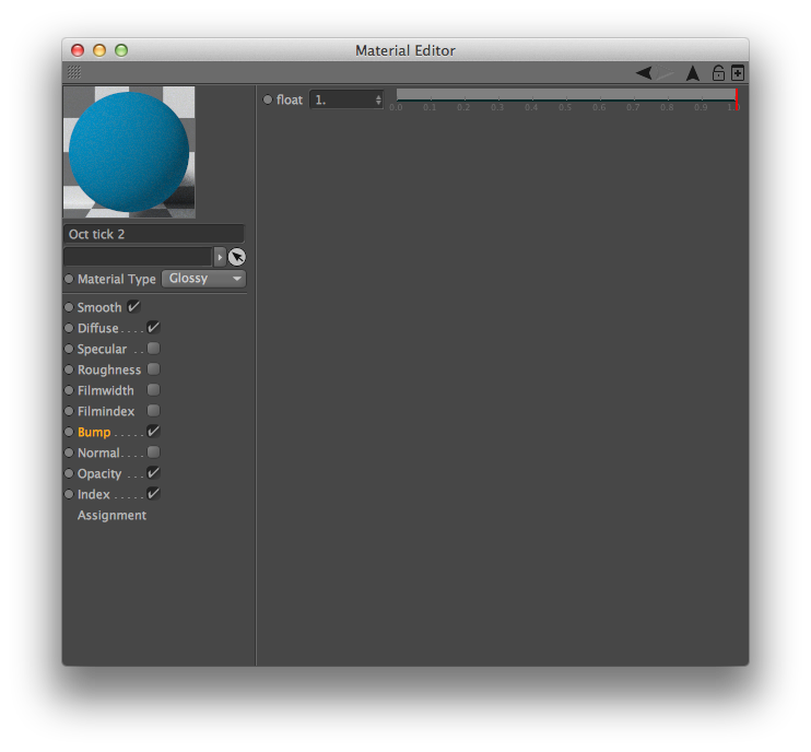

The bump is only slightly visible. I've set the power/float to maximum of .1
See attached material editor.
Do you know if it's it possible to have more depth?
Thanks again

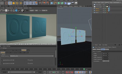

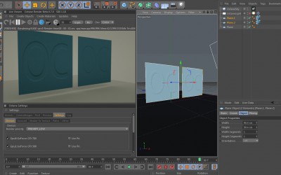

i did a sample. Doing little blur on bump image will give more strong visual. Also some lighting effect can improve bump apperance that you can see in attached scene

Thanks for taking time out to help guys.
@atome451
the displacer is a good idea – shouldve thought about that one!
@aoktar
The blurring works a treat!
Thanks again
