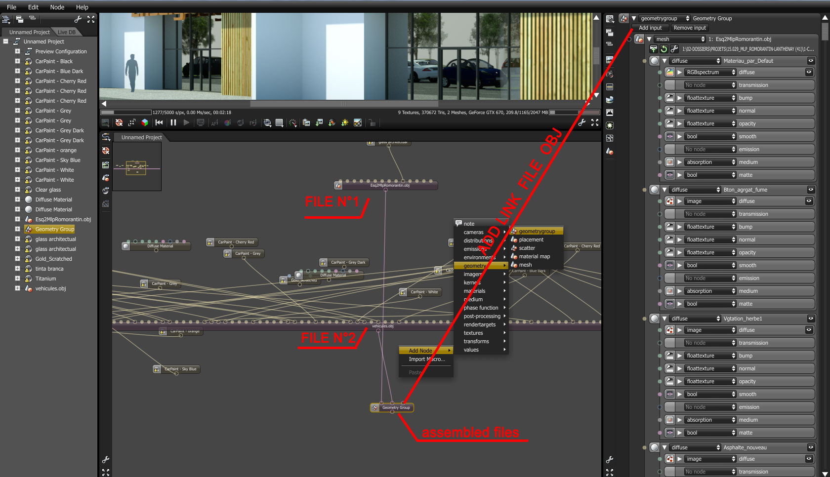

Purge your file, it will probably solve the problem
Windows -> model info -> statistics -> purge unsed
or divide your modeling into several files and assembles the octane in:
add node -> geometry -> GeometryGroup and connects all
To add files with materials opens octane files and copy and paste into a new file octane.

Tank you for your answer, but I use all you advised me. I thought that there can be more quicker way to do it.

What is this indivisible part? Pass more details. The way of using the geometry group is the most efficient.
