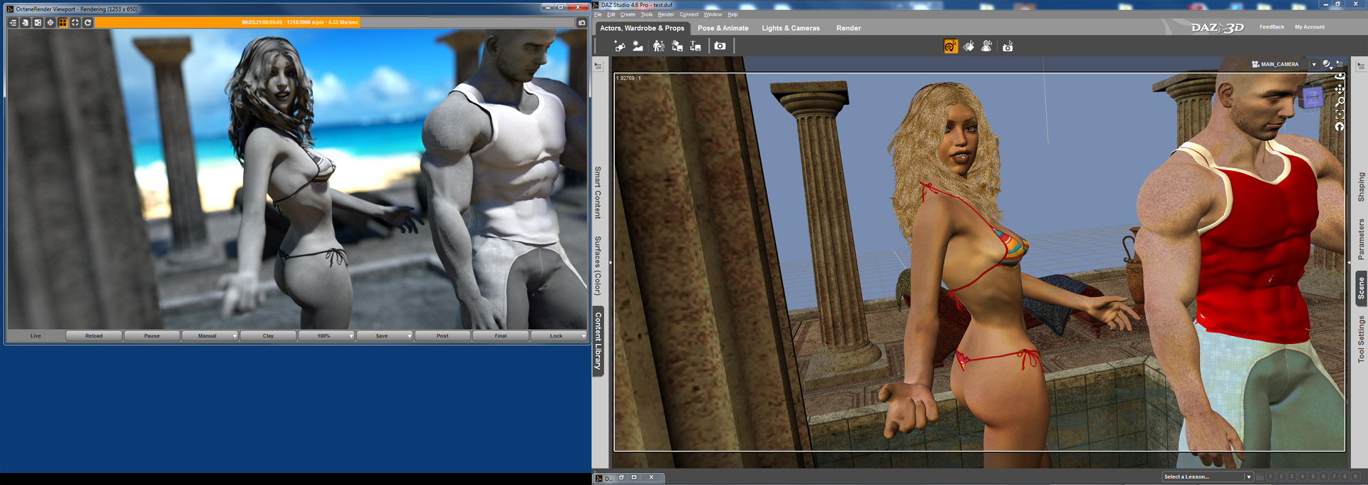

Texture colors from Daz3D are not transferring properly to OctaneRenderDS. Everything appears black and white! :?: Why? How to fix? Thank you.
This happened with Daz3D 4.5 and the upgrade to 4.6. In 4.5 the bug could be addressed by dragging in a new texture (like eyes) inside Daz3D to refresh textures, but in 4.6 the black and white persists. :?
I am using OcDS UPDATE v1.0.113.2313.

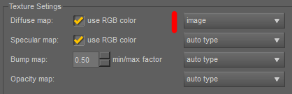

t_3
Posts: 2871
you need to set the diffuse texture setting (in the preferences tab), to "image"; and please tell me, what the setting was before...
