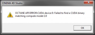

Good morning everyone. At the start of 4D cinema appeared this message.
Does anyone know how to fix it? I tried to update all the software but not

CUDA Api error
it can be texture or ram limit error on gpu. it's consistent message or disapper?maximum07 wrote:Good morning everyone. At the start of 4D cinema appeared this message.
I solved it.
Massimo
I do not think. The same project works on another PC with the same configuration. I don't know what to say.
Massimo
Massimo

Today after install last NVIDIA driver 320.18 I found that message while runing Cinema
and than
Be aware of new NV drivers. Now I'll try to downgrade them.
and than
Win 7 64 bit | 2 x GeForce GTX 660 | Intel Core i7-930 CPU 2,8 GHz | 8GB | Cinema 4d r15 Visualize (no Mograph, no Hair)| OCTANE benchmark scene 2,06 Ms/sec
can you check gpu ram and texture usage when you recieved this message? I suppose reason is either one
