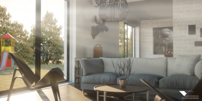

just added fog for raylight effet
I do not know if this is a good solution, but it's the only one I have found to overcome the lack of management background on octane without the need to render two images (hdri + sun)

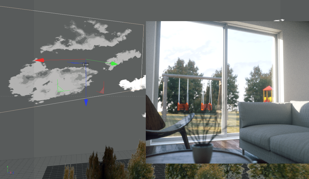

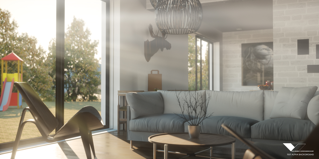

Add Fog raylight Alpha Background + clouds ( update 20.06)

thank you seeker,Seekerfinder wrote:Good thinking there Visual!! The lack of HDRI + sun in Octane is a great limitation for me and many have been asking for it for a long time. So my guess is that the Otoy boys and girls have it HIGH UP on their AGENDA (ahem).
I'd love to know if you come up with a clever way to include clouds in the deal.
Your work is inspiring.
Seeker
uses the same technique, a plan with an alpha texture cloud;)

Hi,sdwhitton wrote:Hi there
not sure what you're doing here - is it an hdri mapped on to some geometry with an emitter added?
No, si a plane with alpha matérial for cloud and background , sun/sky emiter only
