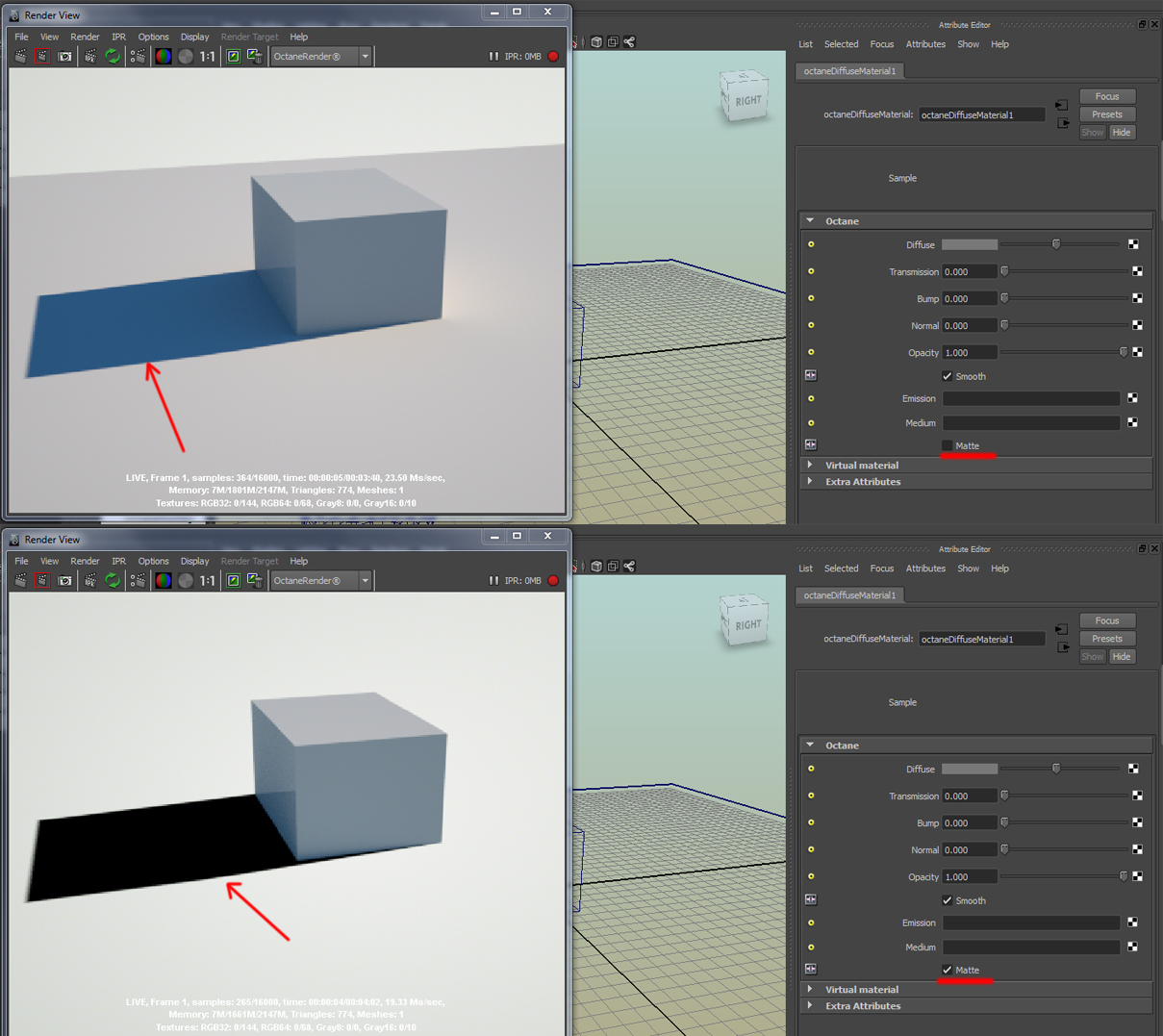

I have problem with shadows :(
When you use function Mate shadows turn black.
Look at the picture.
Sorry for my poor English

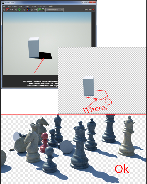

ZLOy
Posts: 42
Joined: Fri Jul 06, 2012 7:04 pm
Location: R.F.
add..
shadows aren`t saved in maya.. in standalone Octane its Ok
JimStar
Posts: 3851
ZLOy wrote:I have problem with shadows :(
I think it may be something with your settings in Maya... You can look at this thread for some info: http://render.otoy.com/forum/viewtopic.php?f=28&t=30787
If you will still get this result, can you please give me your scene where I can reproduce it?..
EDIT: OOps.;) Perhaps I know what is the reason - it is rather not your scene problem, it may be the little problem with 1.14 engine. Should be fixed it in next 1.15 version.
Thanks for report.
