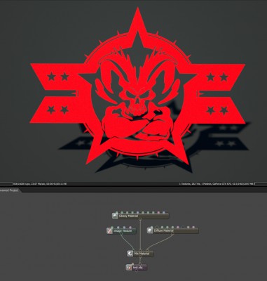

Hello. Here is my question, can I stencil (mask) geometry by bw image?
Here is detailed question with picture:
https://www.dropbox.com/s/zn6micjj8gv52 ... pg?v=0swn-
How to mask simple geometry?

An image in a material mix should work.
Use the image texture in the amount slot.
Use material1 for a material for the inner part and make material2 diffuse, which has opacity 0.

Couldn't you just use a black and white version in the opacity Chanel?
gordonrobb wrote:Couldn't you just use a black and white version in the opacity Chanel?
Yes, this would be much simpler and work as well.

Many thanks!
Win 8.1/64 | Geforce GTX780TI | Core I7 970 | 24GB
Also I found another solution to use png as image and as alpha image texture. This is much simpler than to use mask for material.
