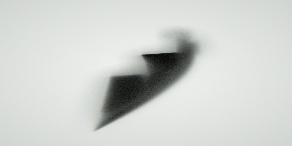

ground shadow pass. Doesn't work 100% as expected. IOR 1.0 should be air, but I still see some bounce artifacts with this value. Specdepth is set to 16, should be more then enough using direct lighting. Path tracing yields similar results. The first image shows the artifacts.
The second image shows somewhat of a solution.
