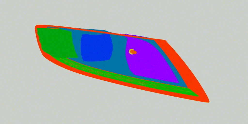

Very good news, a material ID pass will be of good use, i.e. every material in the scene to be a diffuse material with a unique color, this is good in post to adjust whatever you want on a certain object/material.

I like the idea of matID passes. I was thinking of using the Octane liveDB names and assigning a unique RGB value for each. I've done this in other programs like Keyshot, and it worked as expected. If you wanted it to work without the live DB feature, then you would have to assign a unique material name to each shader from your 3rd party application, save an ocs file. Run the script, done.

I've written a 3dsmax script that assigns a unique random color and material to each object. From there you just need to adjust your mesh preview kernal. These settings would be replaced via script, just in case you had animations. The main issue is the background color needs to be %100 black and the objects still need to be visible. Anyone have a solution for this? I don't think its possible with the current toolset.

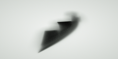

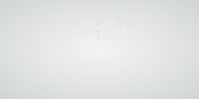

ground shadow pass. Doesn't work 100% as expected. IOR 1.0 should be air, but I still see some bounce artifacts with this value. Specdepth is set to 16, should be more then enough using direct lighting. Path tracing yields similar results. The first image shows the artifacts.
The second image shows somewhat of a solution.
