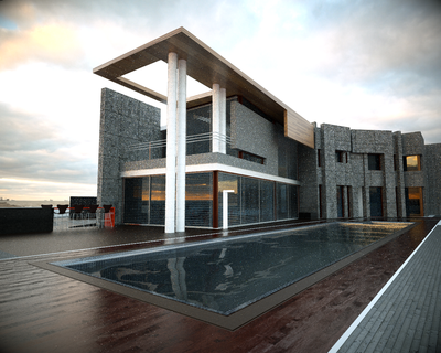

Trying to get a render right with 2.3
I get way too much fireflies with pathtracing and HDRI is this normal?
Somebody got tricks?
Exterior render

Yes indeed, for the moment i haven't managed to get a clean render with pathtracing HDRI and bump/specular maps.
Defly is good but not enough for me.
Directlight seems to work... with bump and specular. Not with HDRI though, either way not with all textures.

you probably have the bump map power on the gray concrete pieces (which are full of fireflies) way too high.
use a low value like 0.1 or 0.2 max and you'll have MUCH less fireflies.

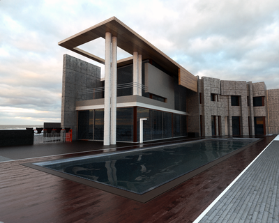

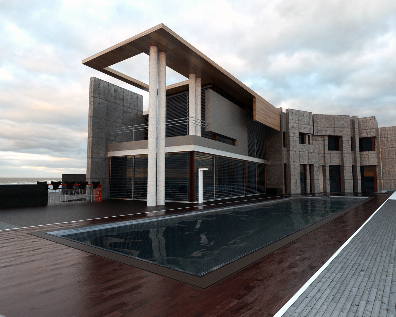

Ok, much less bump, IOR and supersampling. It worked.
I didn't manage to get more illumination without burning the HDRI plate neither in Octane or in PS. I suppose they are pretty accurate.
Need more hi-quality HDRI!! hahah
I like the results. thank you all for the tips!
