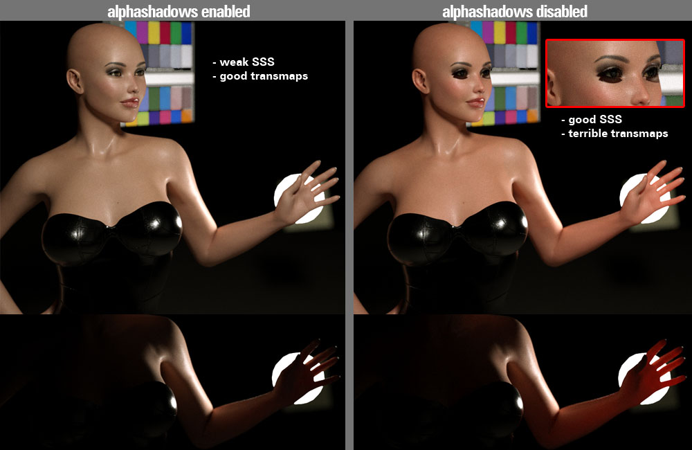

I have seen on this board that you need Alphashadows disabled to get a good SSS effect for skin. (I've tested it for myself and it is true, alphashadows enable kills the SSS effect)
But disabling Alphashadows created a big problem for transmapped hair, eyeleshed, etc.
How do you get around this issue?

Example Issue. This is done (with the poser plugin) in v1.13

JeffGalloway wrote:Example Issue. This is done (with the poser plugin) in v1.13
Have you tried setting Absorption and Scattering to 0 and Phase=Scattering Direction to 1?
Windows 8 64bit, Intel Xeon 3.4 GHz x2, 10GB RAM, GTX 660 Ti 2GB, Poser Pro 2012 SR 3.1
JeffGalloway
Posts: 52
Joined: Fri Mar 08, 2013 6:18 pm
KleanZlate wrote:Have you tried setting Absorption and Scattering to 0 and Phase=Scattering Direction to 1?
Yes, I have tried that - and it does not give the same effect that I am getting with alphashadows disabled. There is something about the alphashadows enabled that deadens the SSS effect especially in the large volumes of the body.

Thanks for the comparison image - very useful. I have escalated this issue to Otoy.

Otoy have looked at this, and been able to reproduce the problem in Octane Standalone, so it will be fixed in a future release.
