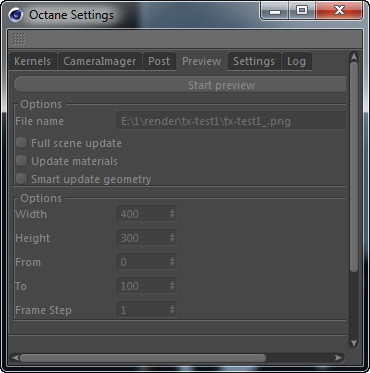

Did you try as in pictures? It's for thatImprodu wrote:Hi all,

Thanks for your replies.
As said, i tried the preview feature but it don't work for me because of the frame step:
In fact, with frame step to 1 the renderer calculates 1 on every two frames.
With frame step to 0 Octane seems to still calculate only the first frame.
Maybe i missed something?
