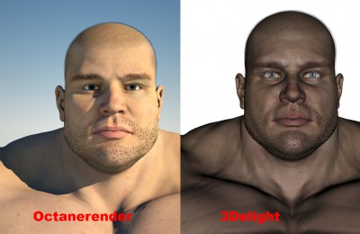

I'm trying to setup my character in Octanerender with some eye reflections and veins via normal maps like it shows in 3Delight. I used the Clear Cornea Material from the Live DB but I cannot see any difference. The character is DAZ Freak 5 modified with my product SWOLE and I have loaded the default DAZ normal maps for the Freak 5 veins but Octanerender is not showing anything.

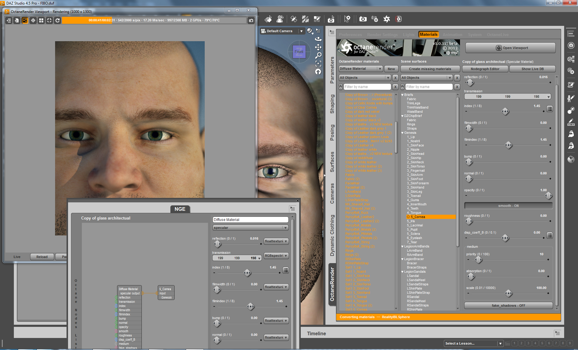

I tried giving a zero opacity to the cornea, loading an IBL light (From Reality) creating a spotlight and pointing at Genesis face but so far cannot get any reflections.

sorry but this is a bit hard to explain in just a few words;
if you work without the cornea: you need the iris as a glossy material - at least. specular/glossy mix might give better results, or specular/diffuse mix. if the iris mat is a diffuse type, of course no reflections will be visible.
but if you see some reflection at all, from a single additional light source, depends on the size of the light source, power, and if the reflection directs to the camera. a rule of thumb: if the light source alone (= environment set to no/null) won't light up the scenery enough, you will not get much eye reflection from it also.
having the type of material you currently use for the cornea might also help (of course not with zero opacity, rather in the range of 0.5), but again, the light source needs to be big enough and bright enough. and the word "cornea" needs to be excluded from the surface filter (have you checked it? sorry if repeating myself, but you didn't mention it).
using the fake reflection map (which is clearly visible in the ds viewport), and mixing it to the iris material is most probably the fastest way; plus using a glossy type with medium roughness for the iris also...
