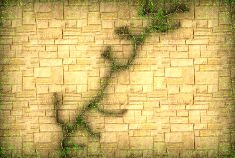

An alternative use for the Dirt node
creating foliage for a wall..try it also with images of moss etc.
Please see attached..

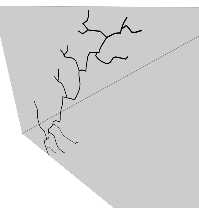

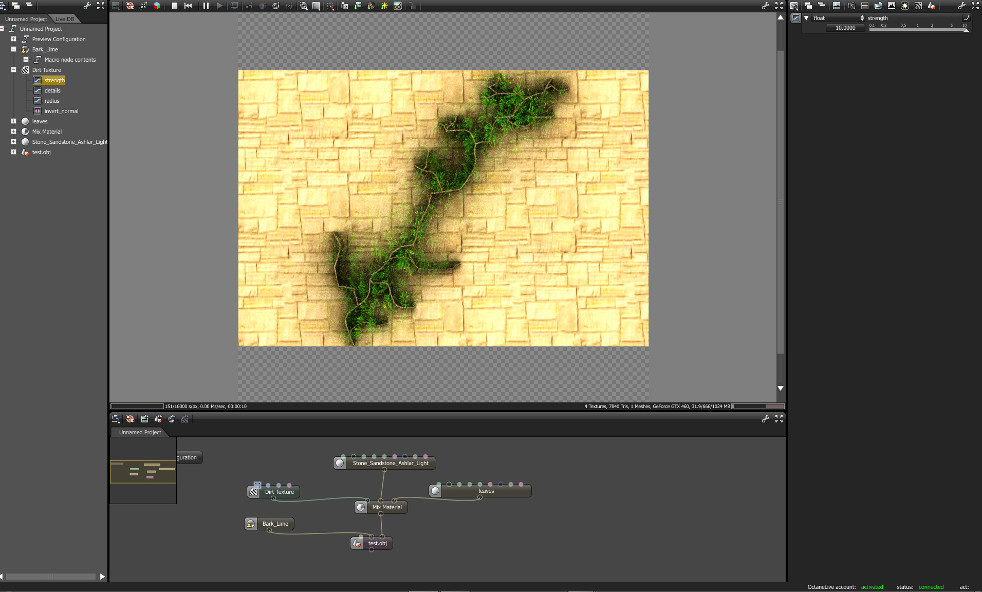

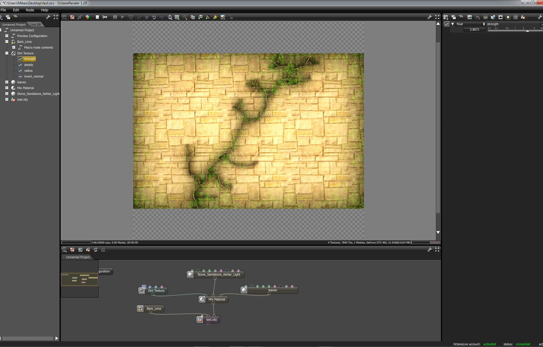

to get this to work i buried the branch's geometry halfway into the wall, the dirt function then picked up the intersection of the wall line and the branch's
i also inverted it to pick up the edges of the wall and varied the strength , radius and details.
have fun !
Jaba
have fun !
Jaba
