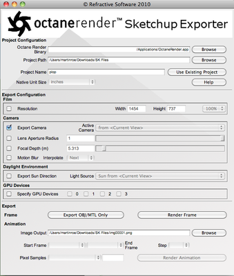

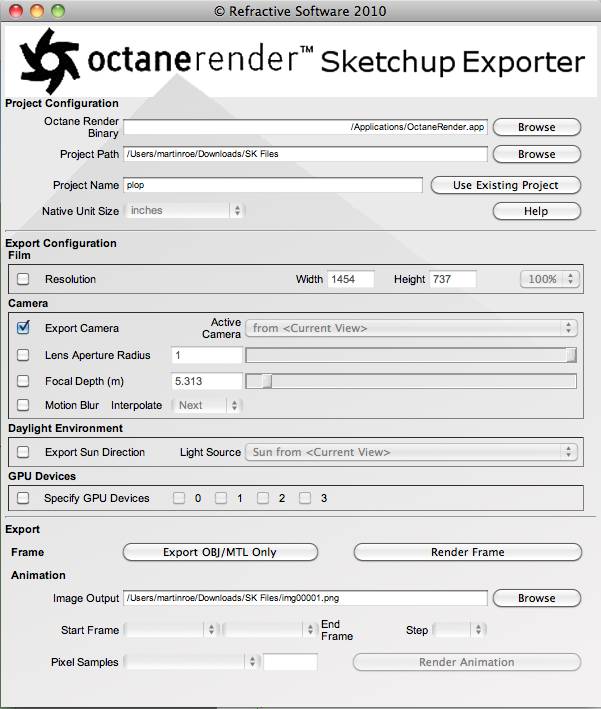

Tig
Hope the screenshot helps.... :D
This is first time opening.
Cheers

Hooray - it now looks like it should look 'by default' - on the MAC and the PC :D :D
Next step, change something but then close the dialog, then reopen the tool, does it show the last used values correctly :?:
The only things I can spot - please tell me that initially focal=5 and you changed it to 5.303 with the slider AND that you have no scenes set up so that the animation options are blank/disabled ???
Next next step, save the model and reopen it, run the tool, does it still show the last used values correctly :?: :?:
Next next next step, if you change the GPU settings are they correctly remembered across uses of the tool/skp in the session or close/open of SKP ?
At last I feel we are getting somewhere :shock: :D

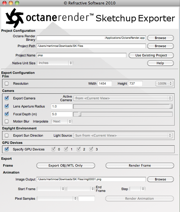

Tig
Upon opening and closing the dialog box, the ticked boxes are remembered but values revert to
default even after I have changed them.
If I save the scene after changing values, upon re-opening the scene and opening the dialog, again
the checked boxes are remembered but the values are back to default.
If I check the main GPUs tick box, the selection boxes are greyed out and I cannot change the number of GPUs
Finally yes I did change the focal originally and no scenes are set.
Hope this makes sense..... :?
Cheers
OSX 10.6.4, Imac 3.06 GHz Intel Core 2 Duo, 8 GB Memory, NVIDIA GeForce 9400

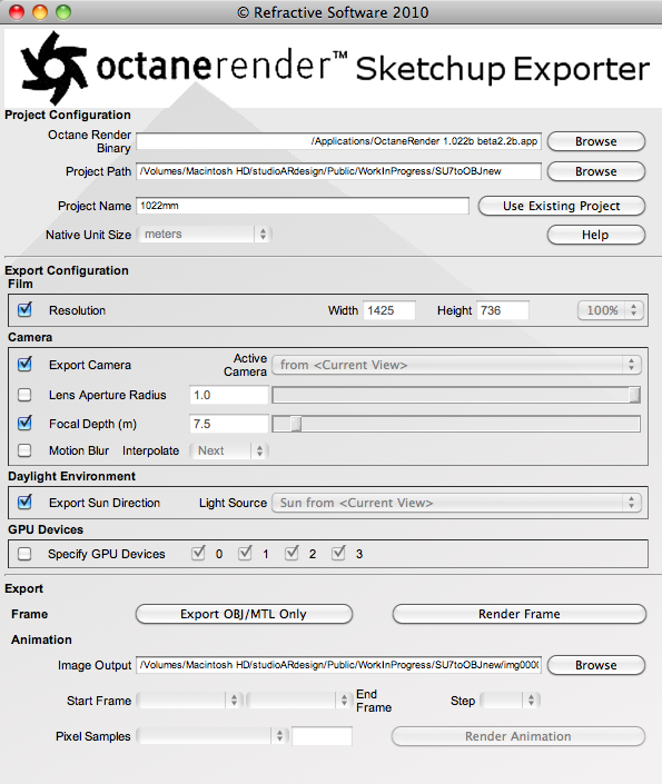

I confirm... it works TIG!
I tried to change some checkboxes/values - save the skp and re-open: the plugin remembers correctly all the changes I made
the only things that don't work as expected are:
1) resolution (even if I check the box I can't change it either typing values or selecting a percentage)
2) GPU devices: if I check the box all the GPUs are selected but greyed out
cheers,
A
