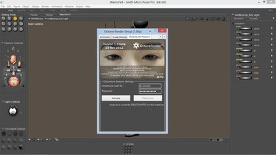

Cant get past this screen
Moderator: face_off
spawn2002
Posts: 14
Joined: Sat Jan 28, 2012 12:57 pm
Installed the plugin,checked & dbl checked the files are correctly placed.I cant get past this screen though to evaluate the demo.All help appreciated.
Win8 64Bit,
16G Ram
Poser version 9.0.3.23027
Gt550 TI video card
TIA for all help.
Paul :)

Hi Chris & thanks for the reply.I should have mentioned that this is the demo i'm trying to evaluate before deciding on purchase.I cannot proceed any further than the mentioned screen tho' to evaluate.No tabs will allow anything other than their selection.
TIA :)

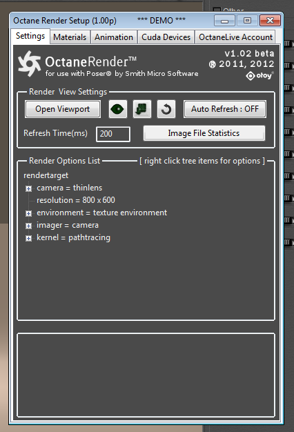

Hi Paul, I downloaded the installer you downloaded, installed, and it worked OK. I notice that you have the correct version (1.00p), however it has not picked up that it is the demo version (see the window title on the image below with the *** DEMO *** in the header). To me, it looks like you have actually downloaded the commercial version 1.00p rather than the demo. Is it possible that you previously downloaded and installed the commercial 1.00p and the files have a newer date than the demo version so didn't install correctly? File date/sizes should be:
C:\Program Files\Smith Micro\Poser Pro 2012\Runtime\Python\addons\OctaneRender for Poser\OctanePlugin.pyc 11/02/2012 264,724 bytes
It this does not help, pls post the octaneplugin.log file from you Poser temp folder (from Edit->General Preferences->Misc) and I will investigate further.
