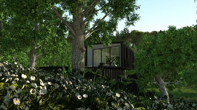

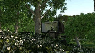

Here is a sample with my workflow Dave_Yu;
Second image is raw render.My animation will be 1280x720 px but I render scene with double size 2560x1440.This scene is very heavy and I have only one gtx 680 4 gb card :) .My goal is 7-8 minutes render times per frame.That is why I render with only 100 max samples and it tooks only 7minutes at 2560x1440 px resolution.
After rendering process I use reduce noise plugin with this double sized image and put a unsharp mask effect for a little sharpness.
And I put this cleared image to main composition which is 1280x720 px. and resize it to composition's size.
First image is result , very clear then raw render and if you want to get this image directly from octane at 1280x720 you should set max samples value to 3500-4000 maybe more.I know there is a bit missing details after this process.But I prefer rendering speed to some details sometimes.Especially in commercial projects.
I hope it helps you.
