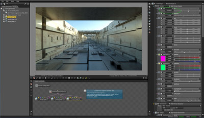

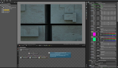

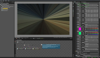

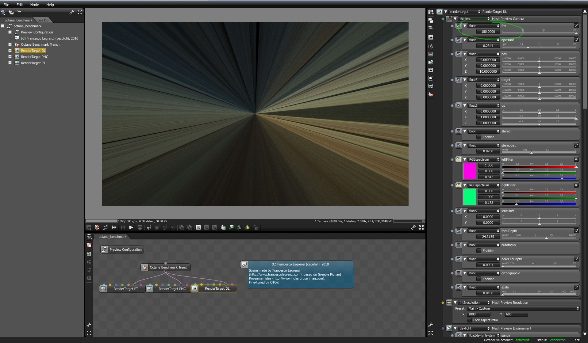

That can not be correct. i tried it with FOV 1, 100 and 180 - please have a look at the pictures i hang on!
If a lens can make a picture of 180 degrees, for axample a fisheye objective the picture must look like this:

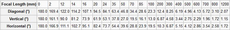

I found on wikipedia a great table, where the angle is correctly calculated to every focal length for a Full Frame Sensor. It is the picture 2:

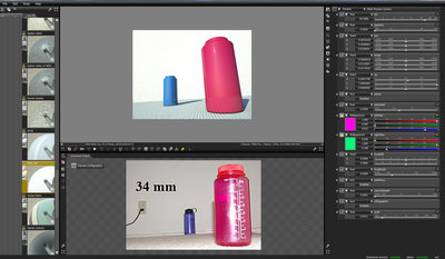

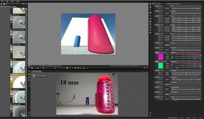

So i quickly drawed these 2 bottles in Rhino and made a quick render for comparison. In picture 22 you can see the comparison between the picture made with 18mm and how octane shows the perspective at 18mm=100 on the FOV slider. Here you can perfectly see what i mean. I tryed to match the scene as good as possible as on the picture, but it looks completely different. I allways added the picture in the render view, so that all of you have a direct side by side comparison!

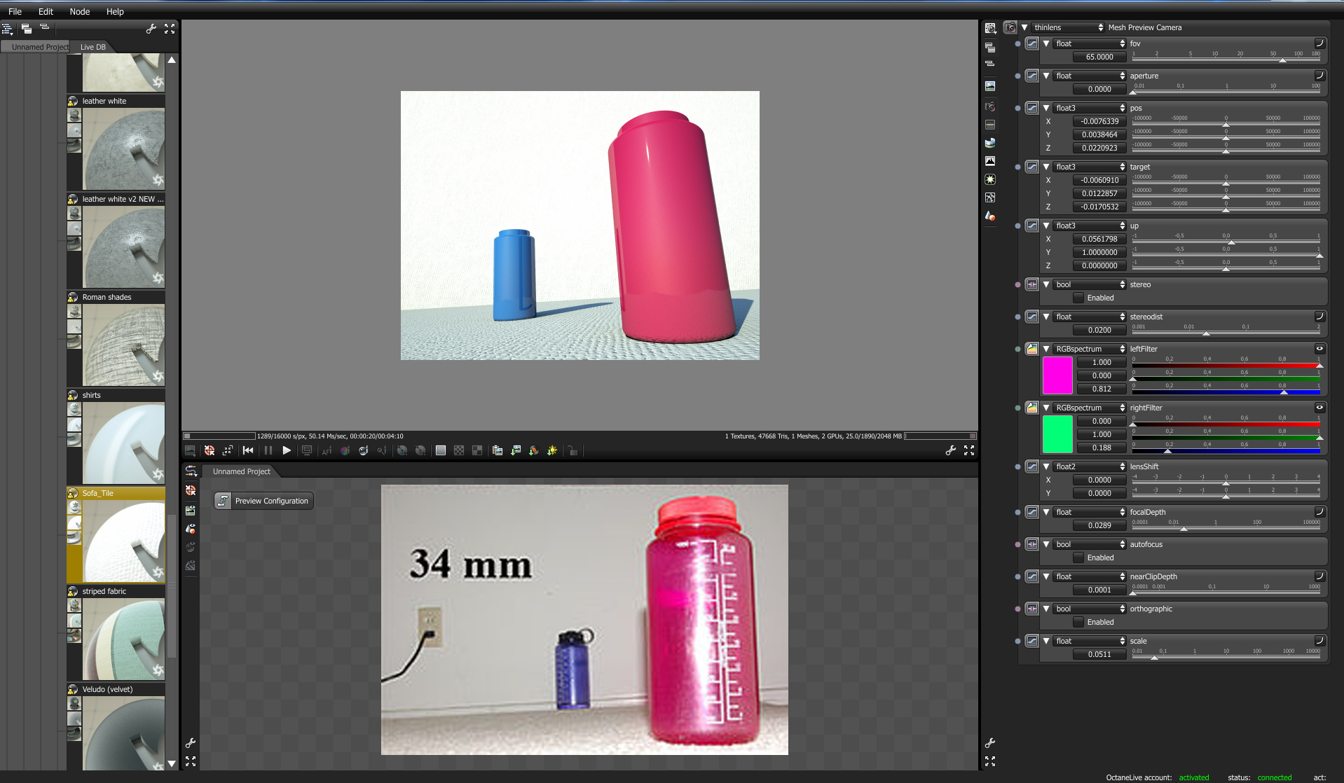

23 shows the same at 34mm focal length. 34mm=65 on the FOV slider:

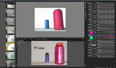

and last but not least the same with 55mm. 55mm=43 on the FOV slider:
As you can clearly see in all 3 pictures, it looks completely different than it "should" be. So how can i make a picture that looks liek it should be? I need that cause of the many renders i have to do for the compositings for the other photographers. I really start getting desperated :-(

hm. for my plugin i need to calculate the octane fov from another camera model, which works ~ like a real camera. if i have focal lengths of 18/34/55mm, the output angles are 111.1/75.3/51.0, given an image aspect ratio of 3:2.
since the original camera model uses the vertical axis, whereas octane uses the horizontal axis to define the field of view, the calculation needs to also take the aspect ratio into account. and the aspect ratio needs to be the same for both models of course. don't know what the system axis for a dslr is, but this is clearly important.
apart from that, the images you did in octane are indeed extremely distorted. my guess is, your scene scale is wrong. using those angles i only get such a distortion if my objects are tiny - a few millimeters "tall"...

I modeled the objects in Rhino in mm and then imported them in octane - also in mm! In my opinion there should be no difference, cause if i photograph a jewelry with 15mm of size with 18 mm focal length, it looks as distorted like a building that is 20 meter high, when i make a full frame 28x36mm picture at 18mm. Only DOF is affected which is a question of aperture and not of focal length. But to make a direct comparison and to be sure, i scaled my objects up to 280mm which is about the size of the bottles should be in real life.
I made an object and put it in octane again and the results were the same. Try it yourself. I added the scene as an obj with the 280mm bottles. Try to get the picture and the perspective like in the photo 21 in the earilier post. I really hope you reach the goal and tell me how you made it! I am desperated here!

Your last renders look right. Tilt the camera up and down a bit and you can see the perspective change accordingly. If the camera view direction is fully horizontal the perspective will be the same as in the pictures.
