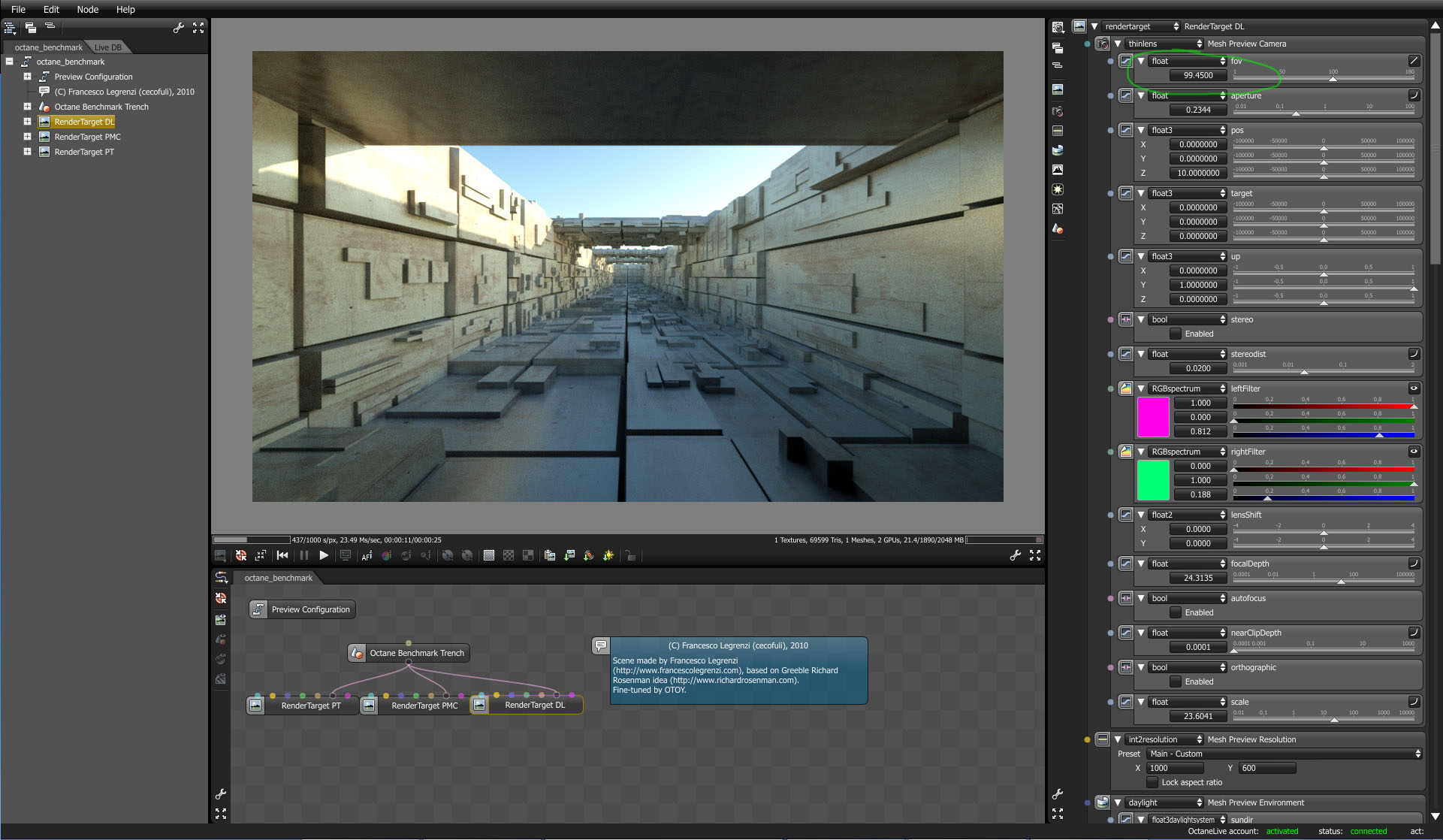

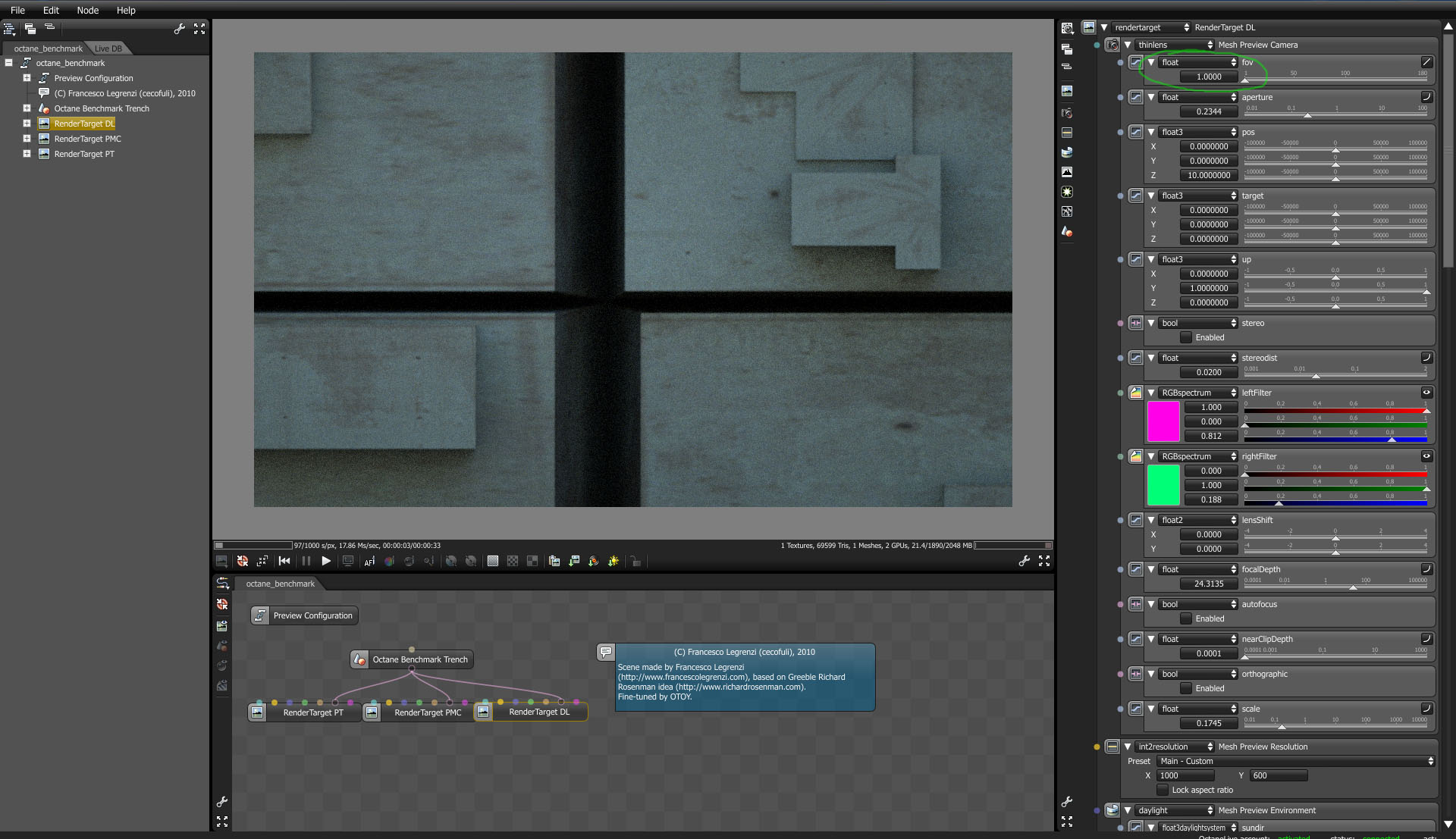

So you mean that the numbers in the FOV slider, in your example 28/29, are the degrees which the "lens" should display in the real life?
That can not be correct. i tried it with FOV 1, 100 and 180 - please have a look at the pictures i hang on!

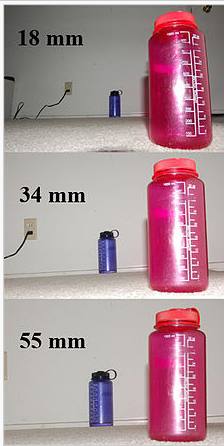

I found on wikipedia a great table, where the angle is correctly calculated to every focal length for a Full Frame Sensor. It is the picture 2:
Also on the same side is a good example, that shows how focal length (not focal depth - focal LENGTH) affects the perspective. It is picture 21:

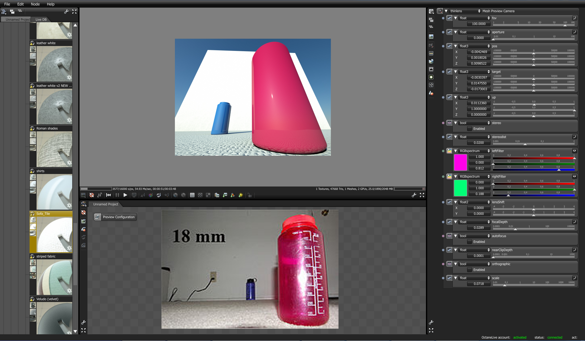

So i quickly drawed these 2 bottles in Rhino and made a quick render for comparison. In picture 22 you can see the comparison between the picture made with 18mm and how octane shows the perspective at 18mm=100 on the FOV slider. Here you can perfectly see what i mean. I tryed to match the scene as good as possible as on the picture, but it looks completely different. I allways added the picture in the render view, so that all of you have a direct side by side comparison!
23 shows the same at 34mm focal length. 34mm=65 on the FOV slider:
and last but not least the same with 55mm. 55mm=43 on the FOV slider:
As you can clearly see in all 3 pictures, it looks completely different than it "should" be. So how can i make a picture that looks liek it should be? I need that cause of the many renders i have to do for the compositings for the other photographers. I really start getting desperated

hm. for my plugin i need to calculate the octane fov from another camera model, which works ~ like a real camera. if i have focal lengths of 18/34/55mm, the output angles are 111.1/75.3/51.0, given an image aspect ratio of 3:2.
since the original camera model uses the vertical axis, whereas octane uses the horizontal axis to define the field of view, the calculation needs to also take the aspect ratio into account. and the aspect ratio needs to be the same for both models of course. don't know what the system axis for a dslr is, but this is clearly important.
apart from that, the images you did in octane are indeed extremely distorted. my guess is, your scene scale is wrong. using those angles i only get such a distortion if my objects are tiny - a few millimeters "tall"...
[edit]: looking at the numbers of your camera position (and target) i'm pretty sure, that the scale is wrong - since those numbers numbers are in the millimeter range... your camera is between ~ 2mm and ~ 4mm above the ground, what apparently doesn't match the photos...
