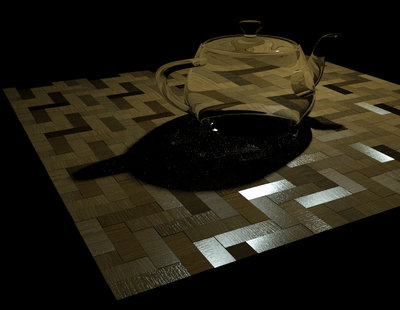

the first image was created to illustrate the problem.
Rendered for only two minutes using one high powered point light through a glass teapot and onto a high gloss floor in the PMC Kernal
The result...as you can see, a hell of a lot of fireflies..

B) select just the areas in the image in Photoshop where the fireflies occur.
C) Run the plugin , maybe once or maybe a few times till the fireflies disappear

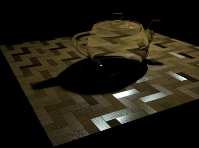

see the before and after images attached:
total processing time.........a hell of a lot shorter than letting the image cook for an hour or two in order to get rid of those damn fireflies.

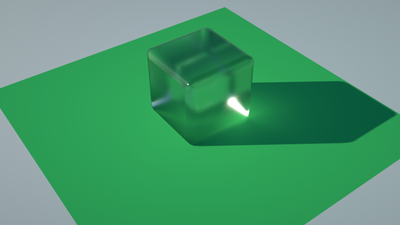

I think the firefly's might be caustics. Try upping the caustic blur and see if that helps some. Here is a similar test I did, although with the sun/sky:
