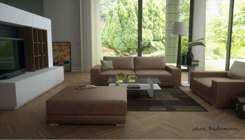

Can someone tell me why my high specular and low roughness objects don't shine ?
Thanks...
I have a small problem with shinny metallic objects.

hi manos, this image was done in octan standalone or octane for 3ds max ?
well, maybe you need increase the specular value 0.10 or 0.20, roughess value 0.05 or 0.005, play with this values
if you use image in the specular or reflect option you can control the shine, playing with the value too.
but away, nice image i like it, maybe the camera angle is not vertical at all, you should fix that part.

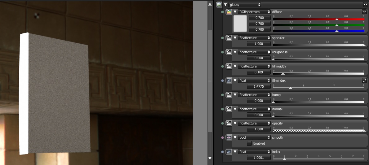

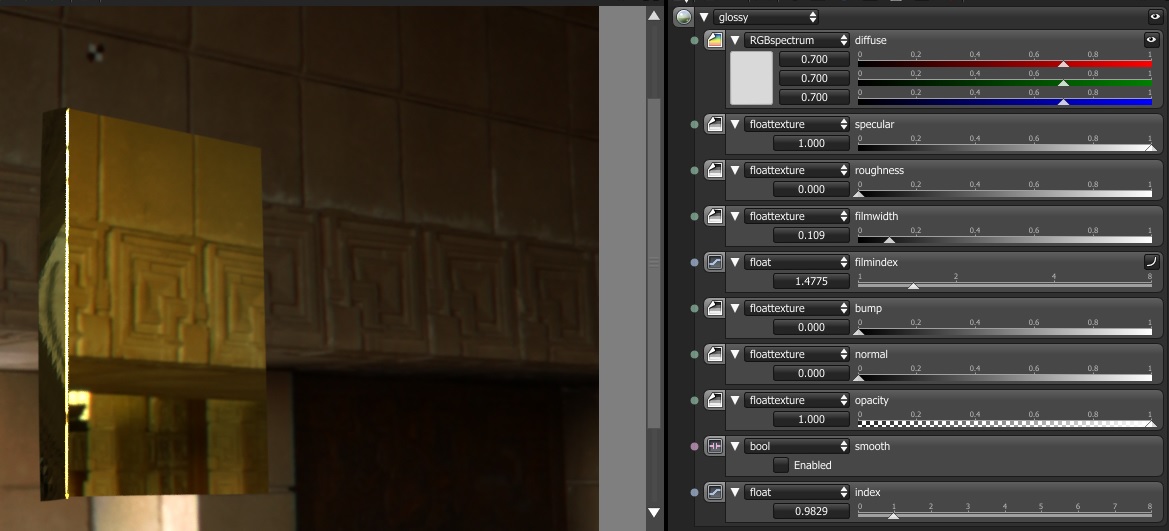

you have to lower the index of reflection !

The Specular setting / Roughness setting just like posted article.
One thing effects "Metallic look" from glossy to Metal. It's " Index ".
Try to adjust it, you will find how it effects outlook of material.
Cheers!
