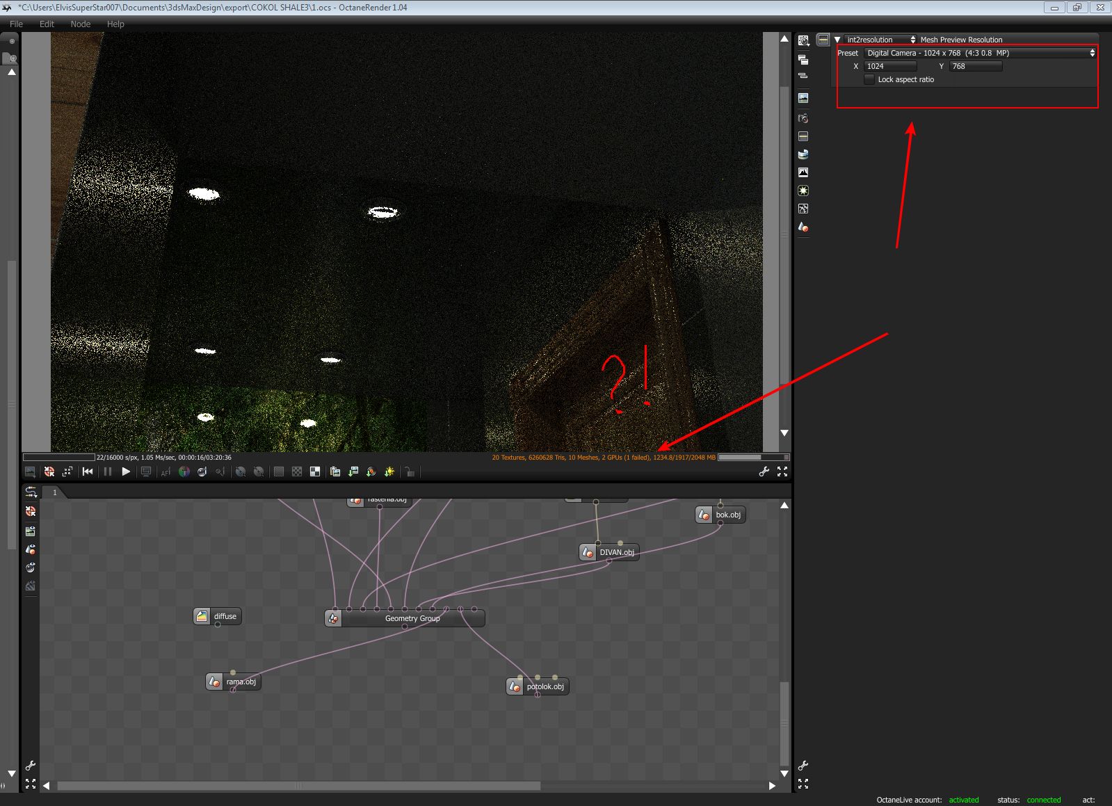

bug
Change the resolution 1024h512 to 1024x768
310.90 NVIDIA
abstrax
Posts: 5516
Elvissuperstar007 wrote:bug
310.90 NVIDIA
Does anyone else have similar problems? Elvis, what does the log say (Help -> Open Log...)?

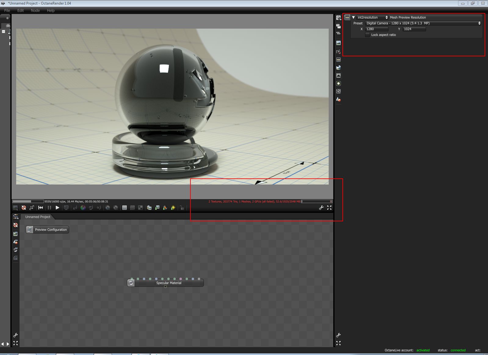

Jaberwocky
Posts: 976
Joined: Tue Sep 07, 2010 3:03 pm
Abstrax
Yep, it happened to me.
Switched to custom resolution and input 1024 x 768
see attached.
Also noted that the interface is very sluggish now for those of use using a single GPU for display and rendering.
CPU:-AMD 1055T 6 core, Motherboard:-Gigabyte 990FXA-UD3 AM3+, Gigabyte GTX 460-1GB, RAM:-8GB Kingston hyper X Genesis DDR3 1600Mhz D/Ch, Hard Disk:-500GB samsung F3 , OS:-Win7 64bit
310.90 NVIDIA
Ok, thanks. It's the autofocus picking that falls apart. Thanks for the report.
