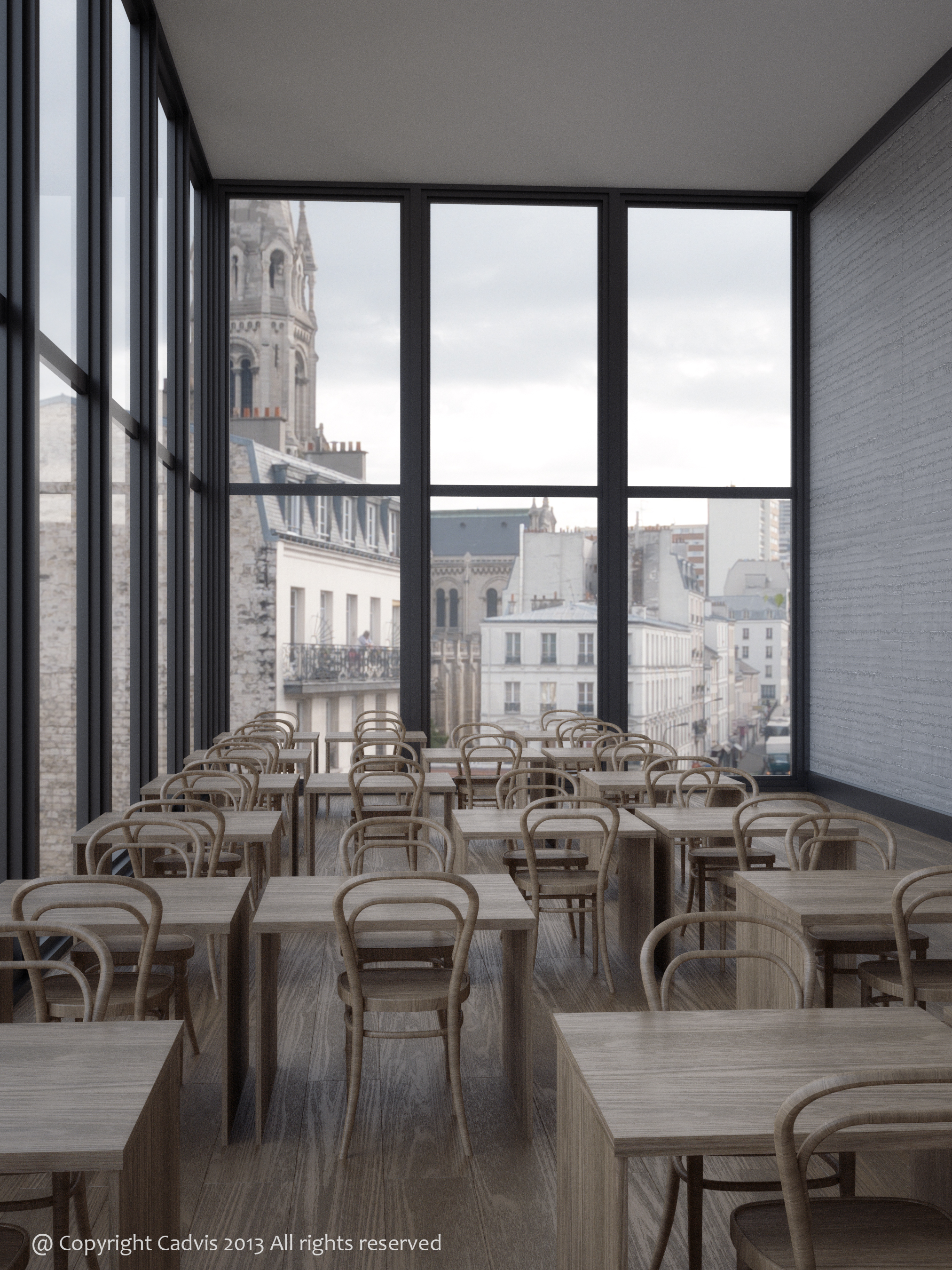

Hello All,
Restaurant Viz..
Some details:
- 600 passes
- Lighting : HDRI
- Kernel: PMC
PC spec:
-Win 7 64bit
-GTX570
Hope you will like it.
Restaurant Viz
- paoloverona

great job cadvis! ...as your usual.
I prefer the one with the sun (don't like too much the choice of using the same wood for the chairs...have you tried with something different or just a glossy black?)
Cheers, Paolo

Thanks ~Paolo for you nice comment.
Yes you're right, probably I should add some difference in wood textures.
I will try to develop further this scene (add some new bits.. plates maybe) and then I'll hope to change wood textures.
Cheers.
Cheers.
@cadvis: There is an issue with the scale of the scene. Either the background image is too large or the furniture is too small. For reference, compare the man standing on the balcony in relation to the contents of the room. The chairs need to be at least 1.5-2x their current size.
This image looks about half done to me. The chairs are way too perfectly placed. Randomize the rotation on the Y a little. Also the mapping of the wood on the chairs is wrong. Wood doesn't look like that on that kind of object. Also, it needs a bunch more clutter of just random stuff to sell it as a real place.cadvis wrote:Hi ~PAQUITO
Yes I did some retouch in gimp - simple color correction & light curves adjustment & blur (is it looks bad?)
I've added new version.
Just my thoughts. It's getting there. Just not done to me yet.
